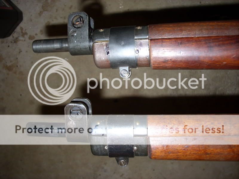

So, how about a .303 chambered barrel with a .308 bore? I would allow you to use standard and common ,308 bullets and is modern rifleing was used would be able to take advantage of a larger selection of bullets since the Enfield rifleing seems to prefer flat base bullets only.
I remember some people doing this for a sporter but would like a military spec rifle.
How difficult would it be to get a barrel made up? I imagine the tricky part would be the front mounting point for the front sight.
