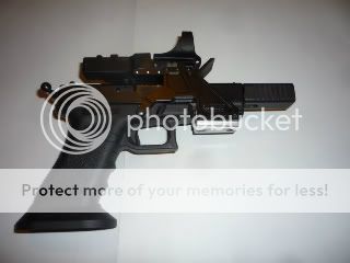

I don’t see any reason to why not , below 2 of my open 9mm open major guns who where build from G17 and Tanfoglio Stock II production gun .
And as far as competing all I can tell you is this
I went to last WSH with an $1800 production gun and got my ass kicked from the guy that was using Glock ,Berreta , and the one using Grand Power …..
Cool. Can I ask you why you did not just buy a Small frame 9mm major Open gun...(Eric Tanfoglio)?
Well I had 2 Stock II this was the backup production gun and was not getting much use , so got the compensator from the Tanfo web site converted the trigger to single action ,just drop in parts from Henning and had my friend/gunsmith machine and thread the barrel to fit the comp . Considering I already had the gun this was a better option.
