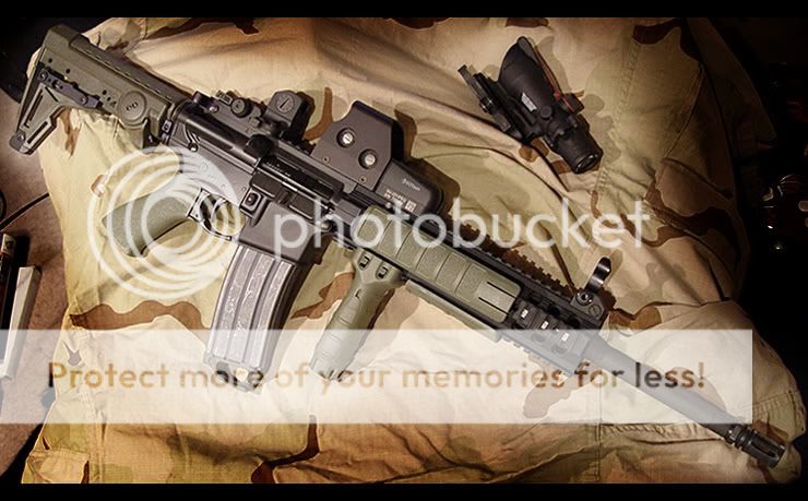

here are some pics of what i want it to look like.
hope this helps out.

Stay with the .223/5.56 as this is the standard cal for AR-15s. The first and third pic show 10.5" barrels and extras. Consider your build in sections
1- Upper Flat top upper with X" length barrel. Will need a low profile gas block or grind down the original if you are putting a railed forend on over 7". Sights and scopes/dotsights are a bolt on affair
2- Lower 2a-Reciever and trigger group ect
2b- stock ect(looks like you want the folding carbine style) get a pic of the exact model and shop the dealers up top or the EE as they are hard to get over the border now;)
If you shop the EE you will find a good selection of short uppers from 7"-10" 14.5" ect look around a bit. $3000 will get you a nice setup:D
