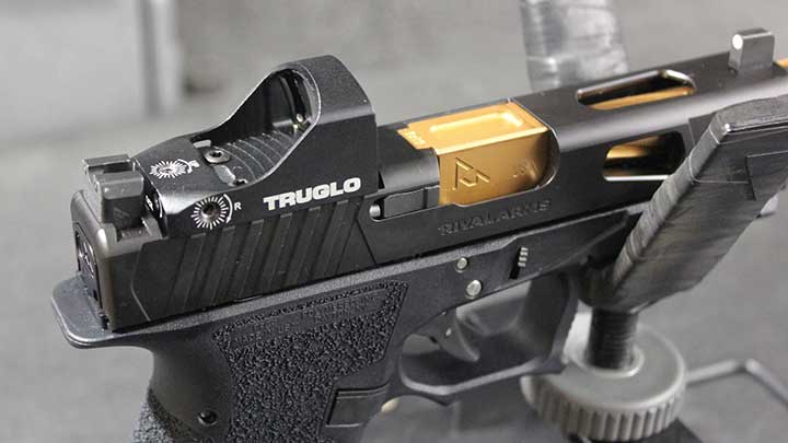

Rival's match grade drop-in Precision Upgrade Slides are CNC machined from billets of 17-4PH stainless steel. They're treated to a QPQ thermo-chemical case hardening for added wear and corrosion resistance along with increased lubricity. These slides feature front and rear canted cocking serrations and three weight reduction cutouts that also work to cool the barrel.
The Rival Arm's match grade slide and barrel used in the build.
Customers can choose from RMR or DOC type recessed cutouts depending on the model of micro red-dot optic they prefer. In this case, I went with the Gen 3 Glock 19 slide with a black finish and a DOC optic cutout to accommodate a TruGlo Tru-Tec micro sub-compact open sight with a green laser dot.

Rival's match grade Glock-compatible barrels are CNC-machined from 416R stainless steel billets and treated with the customer's choice of a Black, Graphite or Bronze (shown) PVD finish. These spiral fluted barrels are available in standard lengths or in 0.5”extended lengths with 1/2 X 28 TPI threaded muzzles (matching thread protectors are provided). The bore features 1:10 right-hand twist 6-groove rifling and the BORSLICK boron nitride DCD metal treatment which works to reduce heat and carbon buildup.
The Lone Wolf Distributor's Poly80 Spectre Compact Completion Kit and Jentra Channel Liner Tool.
The Rival Glock 19 threaded barrel used for this build is supported by the company's in-house recoil assembly which features a CNC machined stainless steel guide rod and a captured flat wire spring. Rival also offers stainless steel frame pins and an extended slide lock lever, both of which were installed in this pistol.

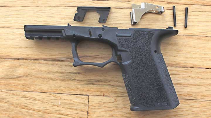

The stripped polymer frame incorporated into this build is the Brownells Polymer80 PFC9 Compact for Gen 3 19/23 which is available in eight different colors. Although Polymer80 made a name for itself with 80-percent frame kits, this particular frame is fully completed and serial numbered at the factory. Features include a 4-slot Picatinny accessory rail, finger rest trigger guard, an extended grip beaver tail and aggressive wrap-around texturing on the grip frame.
The TruGlo Tru-Tec micro sub-compact open reflex sight with green dot.
The front strap is free of any finger grooves, the trigger guard is deeply undercut where it meets the grip frame for added comfort and the back strap is straight instead of curved like the Glock Gen 3 frames. Overall, it's a comfortable grip shape with plenty of purchase for competition or self defense.
The Lone Wolf Distributor's Poly80 Spectre Compact Completion Kit from Brownells provided all of the parts needed to get this frame up and running, including the trigger group, extended magazine release and various small parts. This kit includes a 9 mm ejector and a .40 ejector suitable for either .40 S&W or .357 Sig caliber conversions. I've worked with Lone Wolf for some time now and have yet to be disappointed by their products.
The finished Glock-style Rival Arms pistol build.

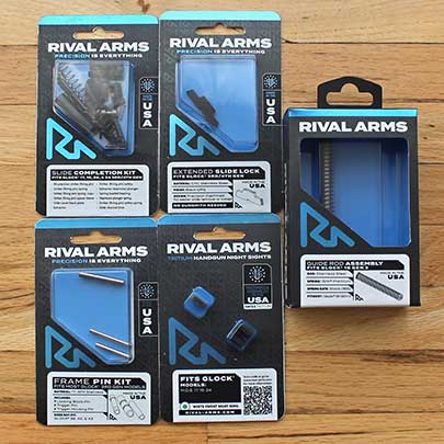

other Rival Arms parts used in the build, including the action spring and sights set.

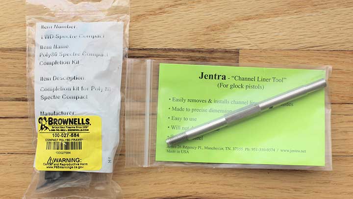

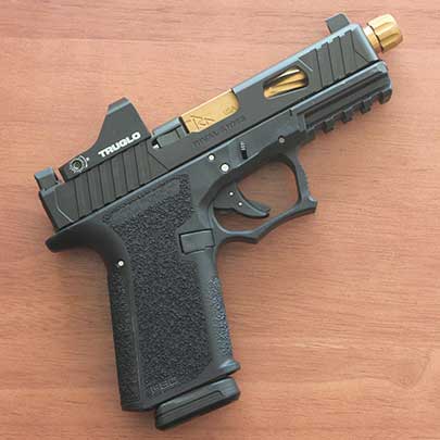

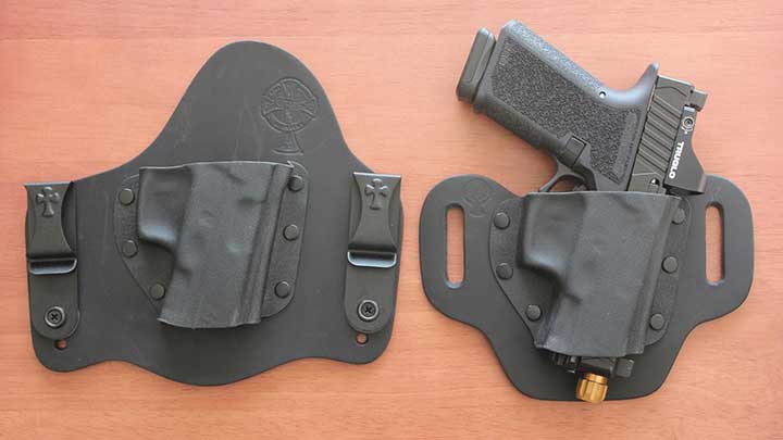

Finding holsters to fit a Glock pattern pistol with tall MOS sights and a micro red-dot optic takes a bit more research than a standard fit. CrossBreed Holsters offers a variety of comfortable fits compatible with tall sights and optics including the SuperTuck inside-the-waistband model and the SnapSlide belt holster.
However, the extended competition-style magazine release presses into the taller leather backing of the SuperTuck causing the magazine to be released when this pistol is holstered. This means I have a choice to make. Either I can replace the Rival's magazine release with a standard length Gen3 release so as to make it compatible with the SuperTuck, or I can keep the extended release and switch to a low back holster.
The CrossBreed Holster's SuperTuck inside-the-waistband and the SnapSlide belt holster.
