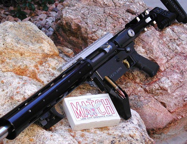

Here you go. If you already have a Remington 700 in 30-06
and the accompanying article from 6mmBR
http://www.6mmbr.com/gunweek091.html
