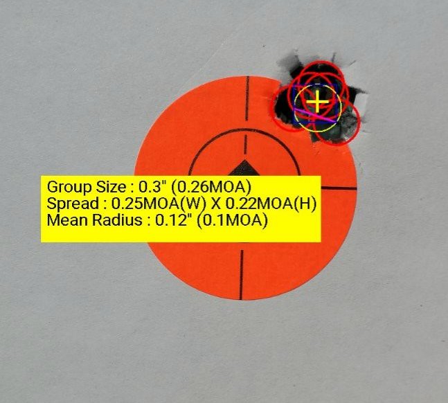

.308 can be a lot of fun and is very accurate. You just have to put the time into it.
5 shot group at 100 meters with a .308
