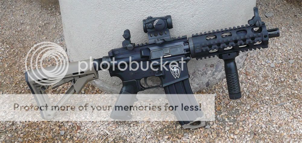

An example might look like this, though it looks like this one has a 7" rail on it.
