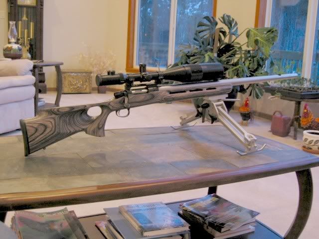

My vote if for the 6 BR,,, Record breaking/setting possibilities at 6-800 yds, dynamite at 3-500 as well.
31" Barrell, 1-8" twist, 107gr sierra's or 105 Lapua's , 29gr. Re/15 gets you 2875fps from Lapuas
Ask Obtunded about his, too.
Mike.
Mike.
That rifle looks VEEEERY familiar!!!
