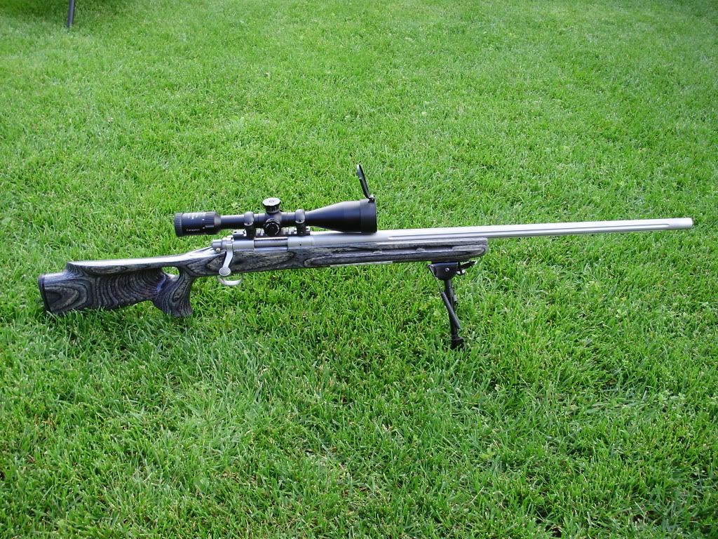

Well you can build one heck of a rifle for that much, depends on what you use for optics i guess. My total package is a grand total of $2800.
with the following:
Zeiss conquest scope 4.5-14x50 mil-dot
warne base
burris rings
krieger barrel - fluted 5r rifling
700 action, trued
700 trigger - tuned
boyds thumbhole stock bedded/floated
bi-pod
all machining included in this price.
This setup get me under 1/2' groups with hunting bullets(5shots at 100)
See what kinda damage I can do with match bullets when i get them loaded
I did do the stock work myself to save on labor and whatever else i could do.
So, you can build with quality for good prices.
here is the beast:
http://i1204.photobucket.com/albums/bb405/KellyTimoffee/0162.jpg
http://i1204.photobucket.com/albums/bb405/KellyTimoffee/P8280016-1.jpg
Hope this give you some insight!! :)

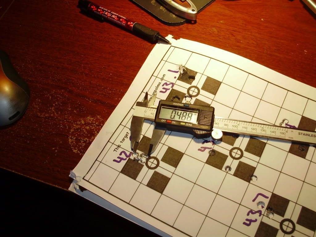

My stock un f**ked with .308 700P shot like this all day long...
My stock Savage10FP in .223 shoots like this... 'Good enough for Gold at the last LE games. :)
Oh and that isn't just a target rifle. That is my do everything rifle. So, even though a low cost, it is even more justified to me when i can use it for paper/deer/moose/coyotes............etc...........
