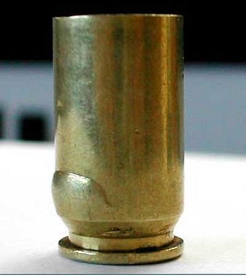

Are you talking about the "Glock Bulge" (from some Glocks that don't have a fully-supported chamber)? A picture would be helpful. If so, recycle that brass and buy some brass without the bulge.

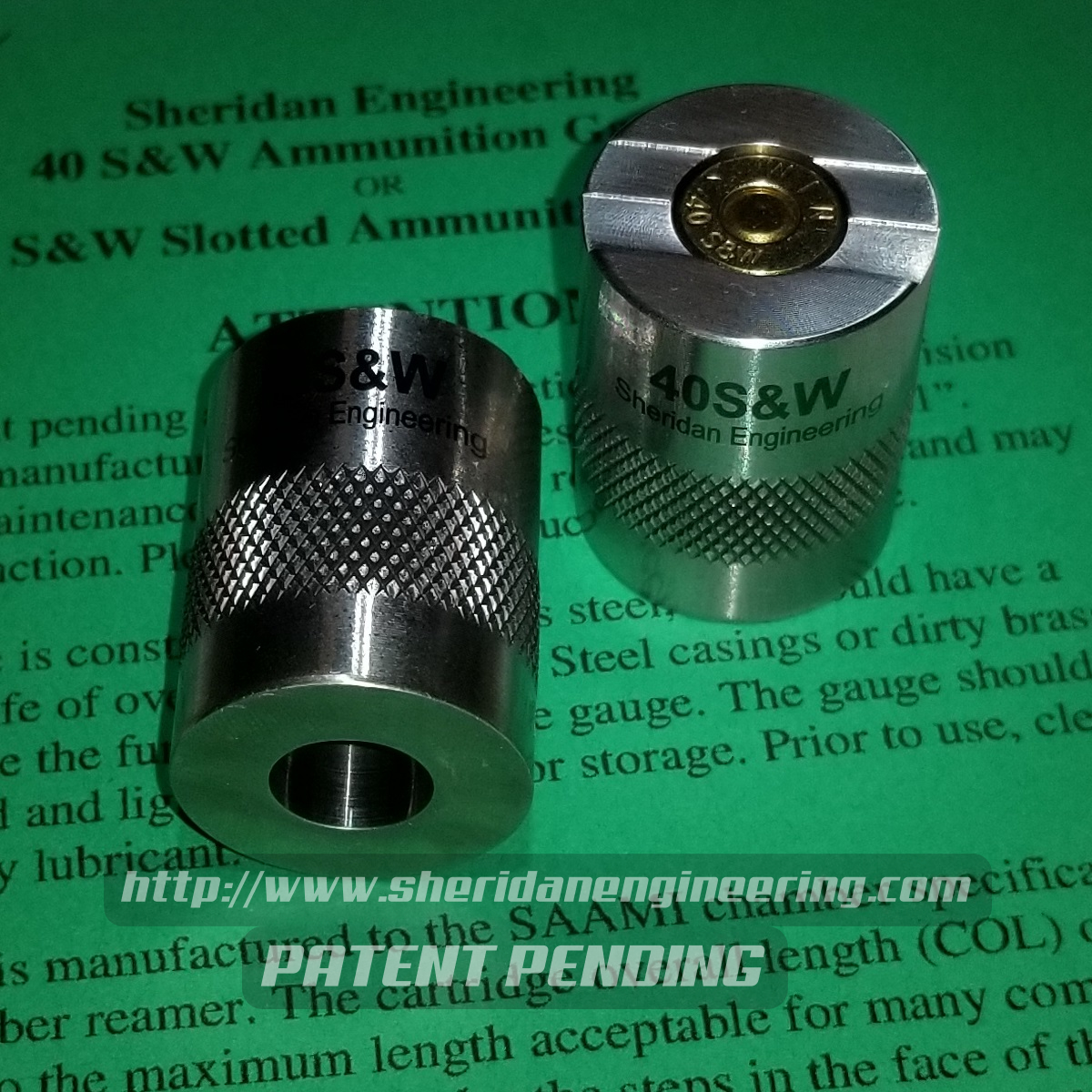

As it happens, I have used a Lee Bulge Buster for .45 ACP, .40 S&W and 10mm Auto to bring cases back to SAAMI spec and it works just great but not necessary if you have a cartridge gauge...
From another site, this is what I'm visualizing:
It doesn't chamber all the way. It hangs up as the case is to wide at the base. I resized the brass..adjusted my dies accordingly. Die only sized so far down the case.
Did the bulges look like the photo I linked to in Post#4? (https://www.canadiangunnutz.com/forum/showthread.php/1664757-Buldge-buster?p=14480741&viewfull=1#post14480741)
If so, scrap the brass as there is plenty of evidence that it's not worth the risk of reloading....

You should also have an Ammunition Gauge such as this:
no, nothing like the picture at all, it is continuous around the case. I think the buster will help

like I said, nothing like that picture. it is continuous and slight. didn't even realize until I noticed the slide not closing properly, then realized oh crap, inspect and then noticed.

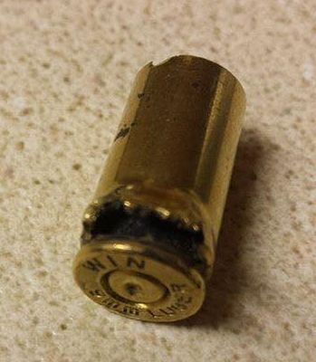

"DO NOT" use a bulge buster die on badly bulged cases as pictured below.
When these type cases are sized with a bulge buster it will weaken the bulged area and the case can fail.
