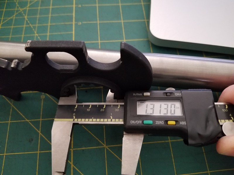

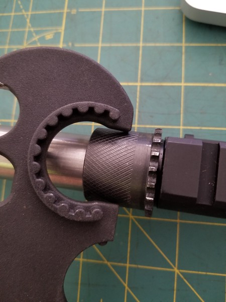

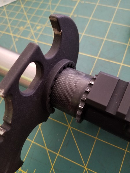

Here is the wrench I borrowed today and its big and still not quite large enough.
Yours Measure big enough Calvin ? If not I will be having to find one online and buy it or modify one/make one.
I can’t see any picture in the last post OP, but in your first post you have a cheap wrench, you need a wrench like Calvin’s for the nut you pictured in your first post of this thread. The tool is wrong, not the nut.
