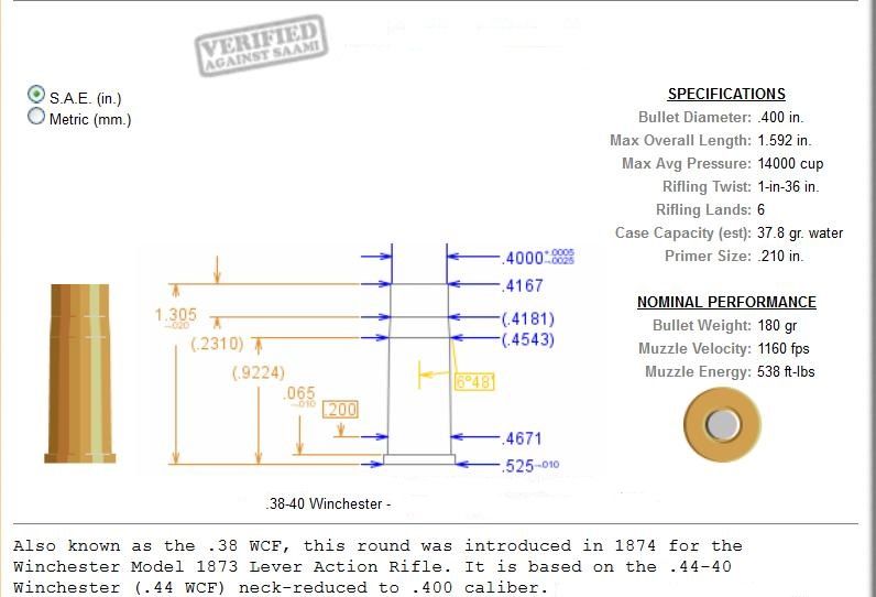

sounds like .38-40...and a problem for sure because that makes it a prohibited weapon.

.38-40, like the .44-40, is much too fat at the base to chamber in many old revolvers which actually were .442 or .450.

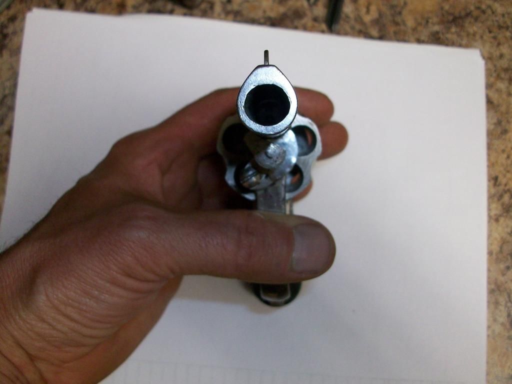

No, it's not a 38-40. The case length of a 38-40 is to long for the cylinder.
X2. Probably a Forehand & Wadsworth, I've the same unit(pocket model by the size difference). At least I got mine cheap, because it's an enigma to figure out what to shoot out of it.
44 Russian fits like a dream. But the muzzle on mine is oval, lol. Really, it a 5 groove bbl so the caliper is always on a land and groove. Another fellow on here kept saying I was measuring Land to land then groove to groove. But it's oval.
It does taper from .430 down in the bbl!

I have one as well. Not sure which route I'm going to go with it. Like yours, it sure ain't a 38-40... As you point out, the cylinder isn't even long enough for that brass let alone a complete round. I think I'm going to sleeve mine. A .40 bullet seated in a slightly necked and cut down .41 Mag case looks to be the way I'll go. Reminds me, I should get on that project again. Keep you posted with the results.

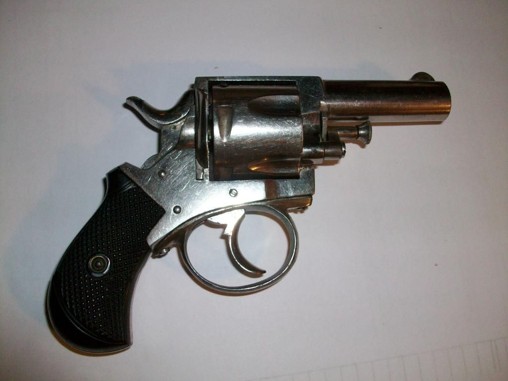

Webley made the original Bulldog revolvers. Or it could be one of the many US or belgian copies of the original Webley British Bulldog.
The Webley Bulldog was originally chambered in .44 Bulldog, which according to Cartridges of the World, uses a .440" diameter bullet and was basically a shorter version of the .442 RIC cartridge. The .442 RIC was also known as .44 Webley in the USA. Several of the US and Belgian manufacturers made bulldog-type revolvers chambered in 44 webley, and great variations in bore and chamber dimensions have been noted.
I don't know of any Bulldog style revolver that were originally chambered in 44 Russian. It's not impossible given the number of manufacturers making Bulldog type revolvers back then, but it would be improbable and impractical.
If you have pictures of the revolver and especially the inscriptions on the topstrap, then I can probably tell you if it is a real Webley Bulldog or a copy. Being a copy is not necessarily bad, some of the copies were very good quality as well. OTOH, some of them were cheap and nasty. Value depends on what you have. We need pictures or there's no way to know.

Pictures coming this weekend :)
I guess it was shown to an enthusiast and he said it was short so it was prohibited, that is all.
It measured the same as a 44 in the barrel, so that part is confirmed at least.
