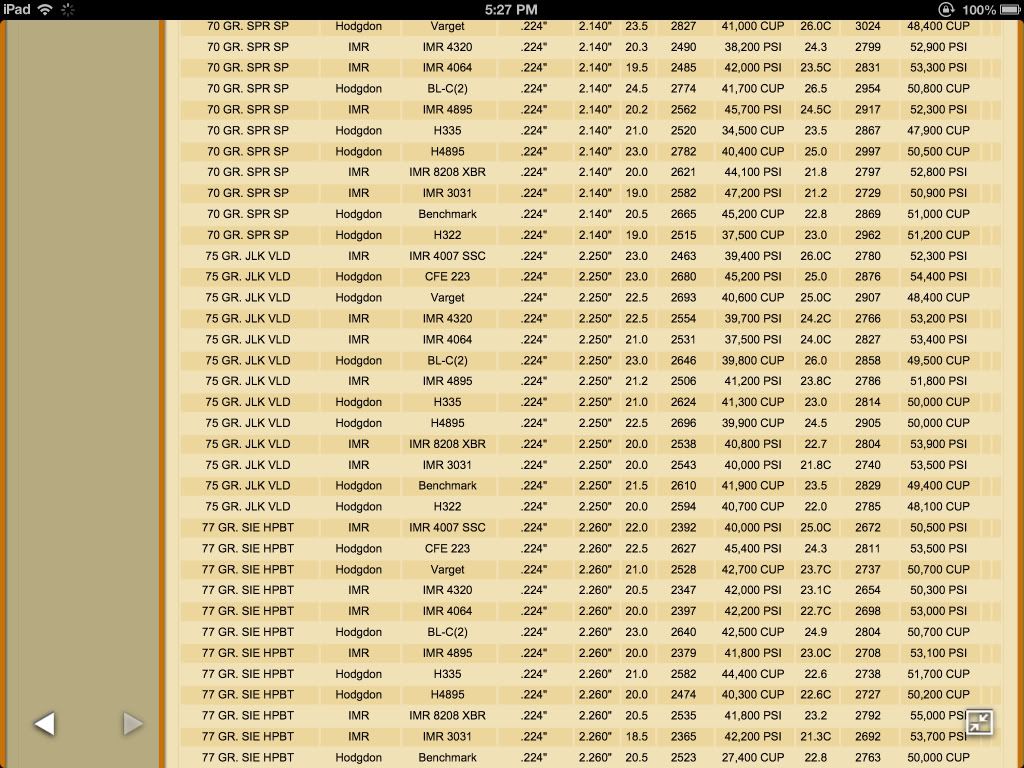

I have a 2 die RCBS set that is only a year or so old. I am pretty new at this, have loaded up a few different bullets in the past month. I loaded some 75gr amax, and the seater left a little ring around the bullet, I read that there is a better seater to use for this length of bullet. I loaded every .5 grains from min to max in both Varget and IMR 4895, as that is what I have. Some of the IMR groups approached 1" but only at loads near 2600 fps. So I ordered some 75 hpbt and 60 gr Vmax, loaded 5 of each from min to max .5 gr increments with Varget last night. The hornady manual is very low wiht speeds and loads, I used the hodgon site for rec powder amounts. Both vmax and hpbt show compressed loads near max. Here is my issue:
As I loaded I set the seater for both bullets at 2.250" per hodgon specs (hornady also). As I reached compressed loads, my COL was getting longer, I adjusted the seater 2x more to make them go down. I noticed this morning that I have deformation near the bullet tip from the seater on the compressed loads. Instead of the curve of the bullet tip , I can feel a curved ditch all around the bullet from the seater. If I stayed in the hornady recommended powder loads, I would not be compressing these loads and have less deformation. Should I be changing my dies/seater? Should I be using less powder? I am still going to shoot them to test accuracy, but will the dents cause issues?

Compressing the powder charge so much that you have to adjust the bullet seater is a sure sign that you have too much powder in the case.
Over compression can also cause the case to bulge(good luck getting them to chamber).
Reliability must come before accuracy or speed.
Now is a good time to get your bullet puller out.
OAL can be lengthened as long as you aren't jamming the bullets into the rifling and the cartriges will feed from the magazine.
Longer OAL may increase pressure and accuracy.

How much powder are you using?
I load the 75gr HPBT with just under 26gr of varget in my 223 and have no problems seating them to 2.25" oal.
I have compressed loads of Varget with long 75 and 80 gr bullets with no problems at all. Take a look at your charge weights and make sure you're in the safe range. I use a Harrel's powder measure with a 6 inch long drop tube so the powder settles in the case nicely. You may need to look at this with your powder measure.

Doenst sound like a die problem to me. All I have is rcbs dies and never had any sort of problems. I also seat my bullets ~.010-.025 off the lands(except for short bullets). Even with 24gr varget and 77gr berger stuffed in the case it isnt compressed.

Don't seat your 75 amazes to 2.25, extend your mag out to 2.50" and then run the long amax out. The ojive is long on the 75 amax and it needs the longer mag space to work.
Thanks for all the suggestions. I did load the amax to 2.390", they fed fine in my aics mags.

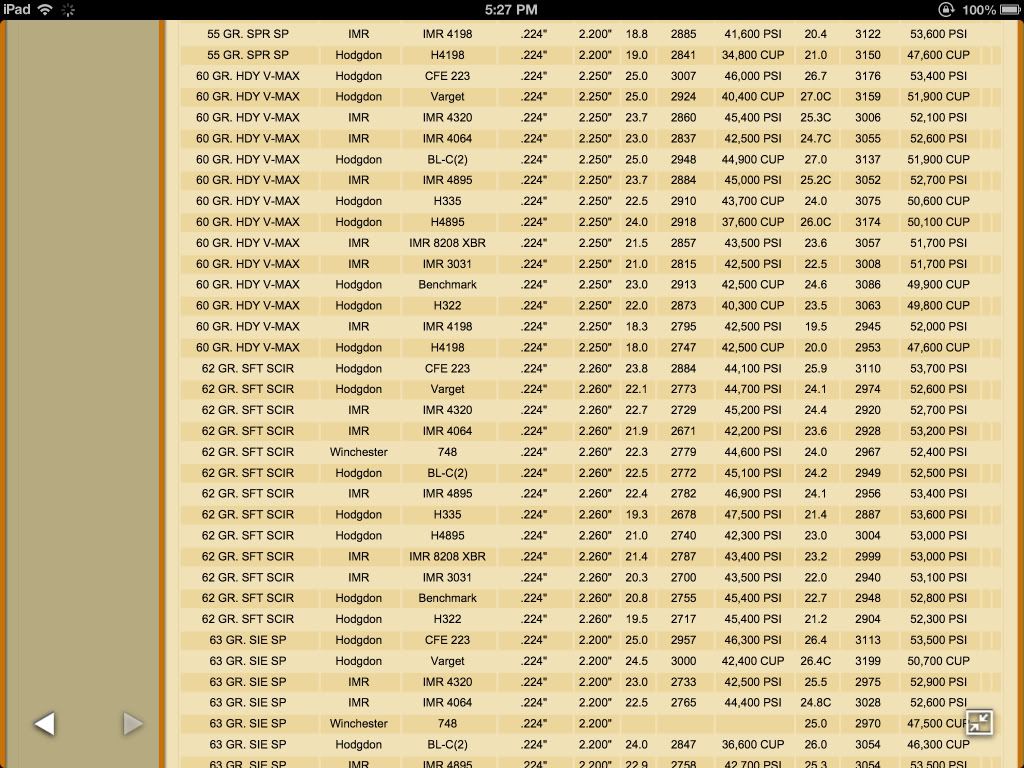

I used the following data from hodgon which shows 27gr max with vmax 60, and 25gr with hpbt 75
