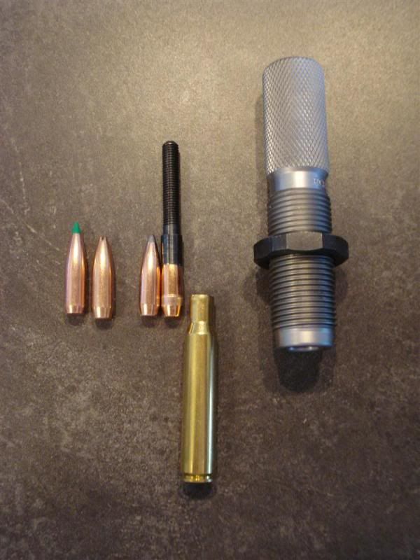

The picture shows from left to right. Nosler 168 or 168gr (cant remember) BT, Sierra 165gr HPBT, Sierra 165gr Spitzer (spbt) and the Sierra 165gr Spitzers stuck in the seating plug, 30-06 brass (lined up where the bullet was seated in the case prior to being pulled out) and the die body.
Maybe this is just one of the cases where I'll have to seat the bullets deeper than I'd like just so they stay in the case. If it matters, the rifle is a Ruger MK-II in 30-06.
I would try a different plug first, second option is to stuff something soft (a small piece of cardboard maybe) into the 30 cal plug to prevent bullet from jamming in the plug. As it is now it seems the taper of the bullet matches the internal shape of the plug causing it to jam in the plug. Just an idea and worth what you paid for it.

From looking at that picture, it looks like you have maybe 1/2 a calibre of neck engaged by the bullet, that may be part of your problem with pulling the bullets out after seating. Can you repeatedly seat them deeper with no problems? The rule of thumb is one full calibre of engagement in the neck for proper bullet retention.
Mark
If the seater plug pulls the bullet back out during the seating process, that tells me you don't have enough neck tension. When you loaded your TSXs, were you able to turn the bullet in the case neck with your fingers? If so, I think we've found your problem. I would either polish the expander ball, try a smaller one, or simply don't use one in an attempt to gain more neck tension.
