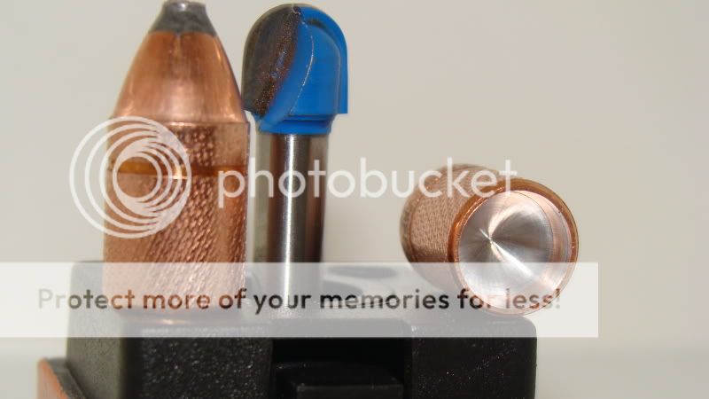

Here's an example of a .458 nosler bullet that I modified to a spire pt. and knurled, I also concaved the base to help with obturation since these are very heavy jacketed bullets.

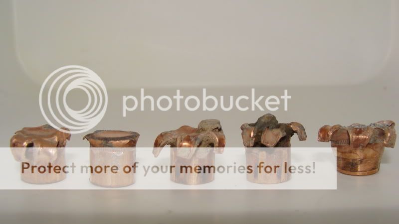

Here's a pic of a recovered nosler bullet with good obturation and expansion ( accuracy was also very good)

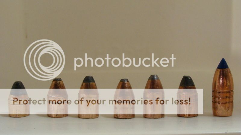

Here's a pic showing various bullets that have been Full Formed for a particular bore, notice the striations on the side of the bullets, the settings on the dies were all different for the different bullets.
Here's a pic of a .458 nosler 300 gr. bullet that I formed to a spire pt.
