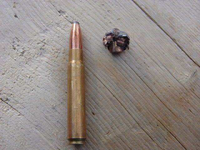

270 gr Speer from 9.3X62 in this year's moose, weighs 225 grains.

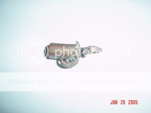

250 gr Barnes X from 375 H&H, bullet tumbled in Woods Bison

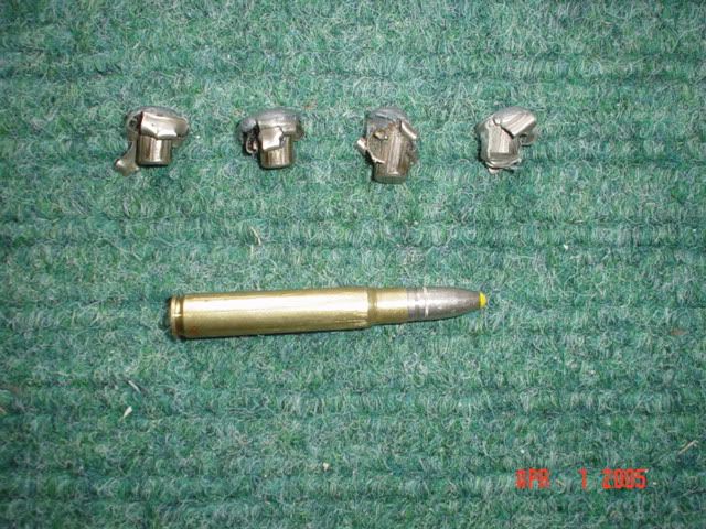

Here's four 286 gr Norma Dual-Cores taken from my old 9.3X62.
As best as I can remember they were all one shot kills, at varying ranges form less than ten yards to around 200.
