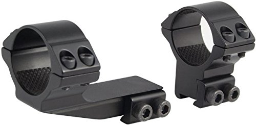

Or get a set of extension (extended) rings (google that).
Most of the ring makers have at least one model of them (Burris, Weaver, Leupold etc).
There is even one brand model out there where both of the rings have an extension so that you can mount a very short tube on a long action.
This is what I'm talking about
They also work great if you need more eye relief than two piece bases will allow for.

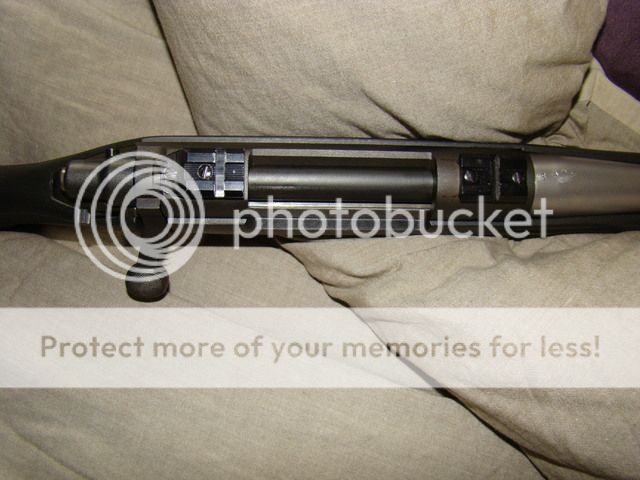

Here are the current bases in place:
Unless those parts can switch places, it looks to me like I'll have to track down new bases.

That's a long action receiver, and those look like Weaver bases.
The weaver front base for the Remington 700 has a centered slot, but the rear *doesn't*, so you might have two front bases. That won't work.
Edit: just looked again. That rear base isn't a front base :)
Get the extension front base, and be sure it's the proper rear base, and good to go. You're $6-$12 away.
