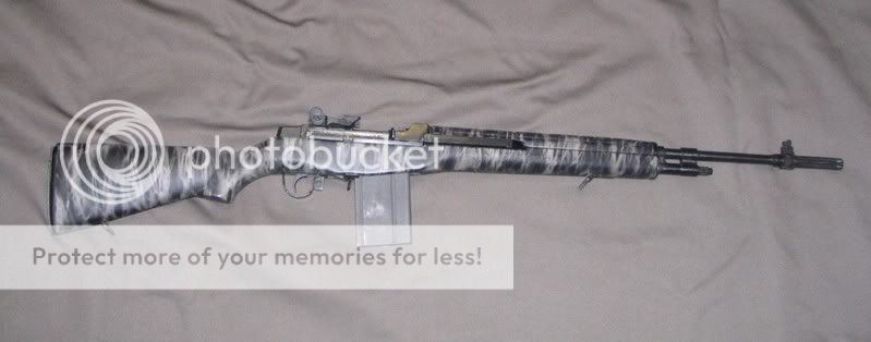

BTB, I hate this picture. What looks like white or grey is actually tan. It's a truely awsome central Alberta fall paint job.
gnmontey that's your rifle!?!
I was there when he just finished that baby!
You must love that job he did. If you ever take that on a fall hunt they will never see you coming!
