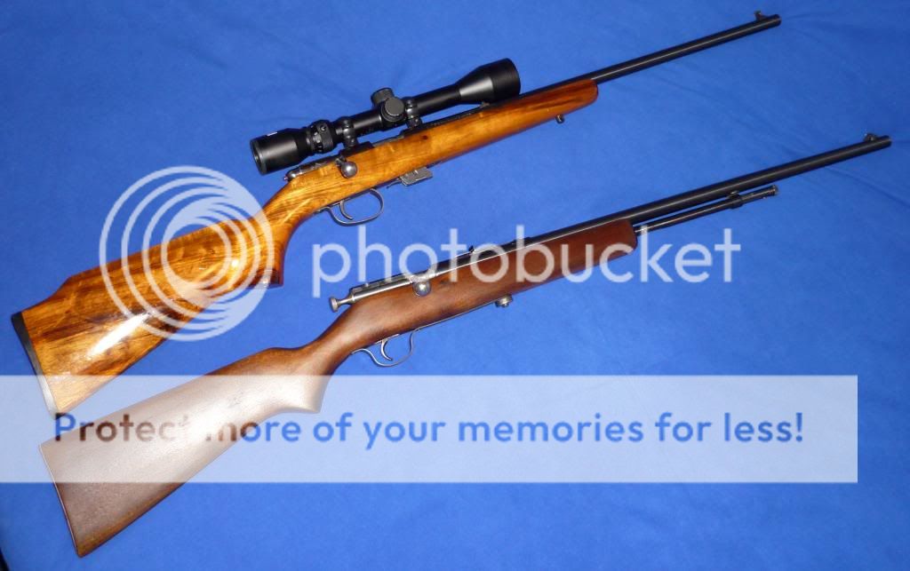

I have one. If you need parts call western gun parts. I just had to get some from them. Mine is pretty accurate although not as good as my cz but will shoot under .5" at 50 with mini mags. Lots of gophers have died when this was in hand. One of my favorites thats for sure.
After refinishing it.
