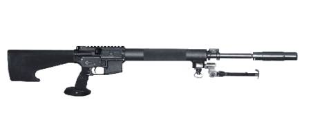

Is this a real pic of the C7CT? Can anyone provide details? Want to build a copy. Acquired a float tube already.

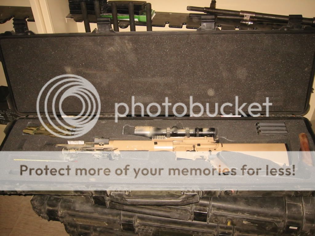

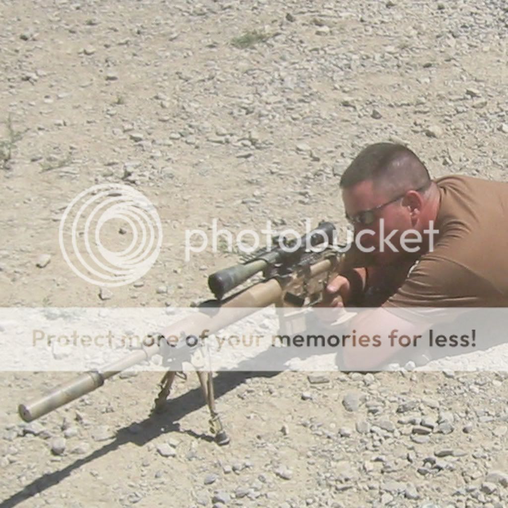

C7CT's where issued like the below (some had A2 grips and some had the Aborto Grip).
The picture above was with a very old KAC suppressor.
The ones that came with the guns where a Finnish Can (via Canadian Tactical IIRC).
They where furnished with the S&B 3-12 scope - but with the Euro turn elevation so if you where used to a Leupold, Unertl etc you would go the wrong way for corrections to range...
Now I think all CF S&B's are like that now (someone correct me its been a long long time) so that issue is moot.
Thanks for the info. Did a search and didn't find much for specs. What is on the barrel? Same sleeve device talked about in the C8 sleeve thread? Barrel length and profile?
Anybody know where I can find a stock like that?
barrel is 4150CMV non chrome lined
Its a heavier than hell barrel -- IIRC a .850 gas block (with gas cuttoff) and heavier under the handguards.
No Simon Sleeve, the barrel is just damn thick.
