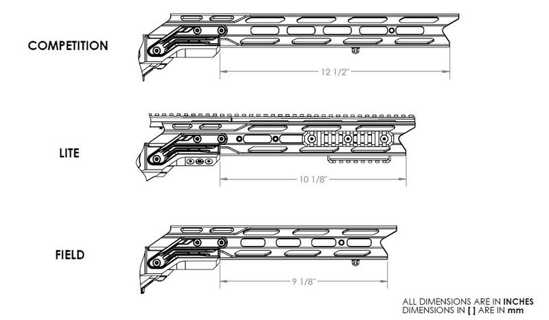

The forend is approx 3" longer. (we asked for this) thank you Cadex

The fixed stock competition model is like a Field OT with a skeleton stock and an improved fore-end tube. I will post the length difference in couple minutes.
