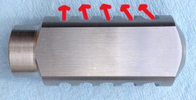

All gill brakes are threaded to TDC. Lots of companies offer different thickness crush washers with their brakes so you can time the brake when it's installed.

The muzzle brake has different angle of port to keep the blast away from the shooters.
