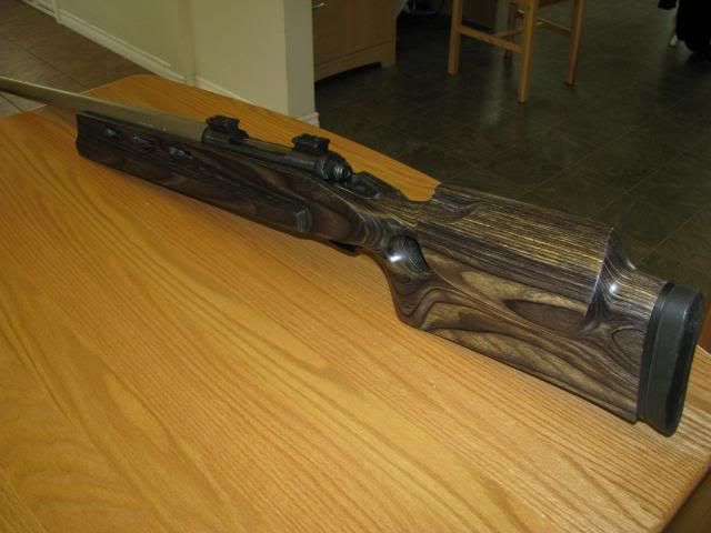

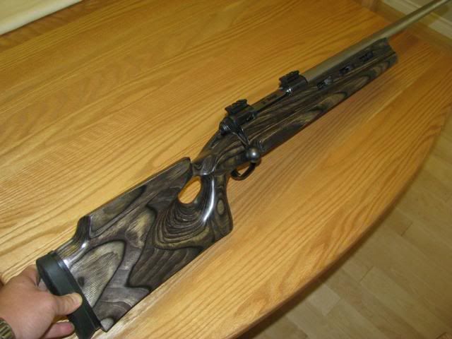

The newest toy is a 6 Mystic in a Richardson BR stock. Will try and post some pics shortly. I really like the feel of the stock but there is quite a bit of woodworking needed to finish. Rides the bags very well. Lots of lead added to raise to 20lbs overall for F class. Recoil is mild with 108gr Bergers.
The 6 Mystic was a redo of an old idea. Take a 243AI reamer and headspace a chamber off 22/250 Win brass. What you end up with is a poor's man version of the 6XC and 6-6.5X47L. Case volume is quite a bit larger so you can get the same velocities without running the same pressures.
Case is approx 4 grains more capacity. Nothing revolutionary but a fun project never the less.
I think the ideal reamer would have been a 6 Dasher. The 243AI reamer that was used is a few thou too big at the case head. You get a very slight bulge. Doesn't affect anything. Just looks odd.
Call it the little brother to my 6.5 Mystic.
Last week, I bedded a Stevens 223 into a Low Profile lam stock. Again, a very nice proportioned stock with VERY generous inletting. Really enjoy the feel and the weight. Nice finish and comfy recoil pad for a change. The barrel channel was cut for a varmint contour so there is lots of space around the sporter barrel.
Still shoots very well and there is zero issue with cooling. A bit more tuning but I hope to hold 3/8 min at 200yds. Pretty close.

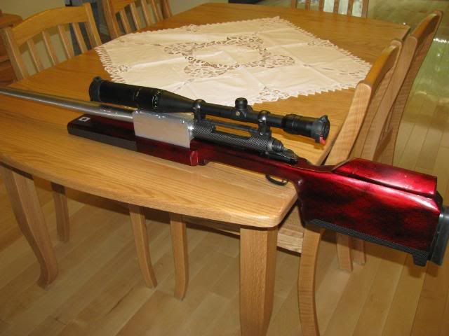

The 6.5 Mystic now sports an adj scope base so that I can get mondo elevation adjustment for extreme range shooting. Adj cheek rest too. Took it out to 2.09km a couple of weeks back. That would be 2300yds - GPS ranged. approx 5 second time of flight.
Gives you alot of time to spot your own shots. In fact, you look away because it takes so long. Will try to get out to 2600+yds if I get some time and calm air before the snow falls.
That stock sounds familiar. ;)

Lots of pics:

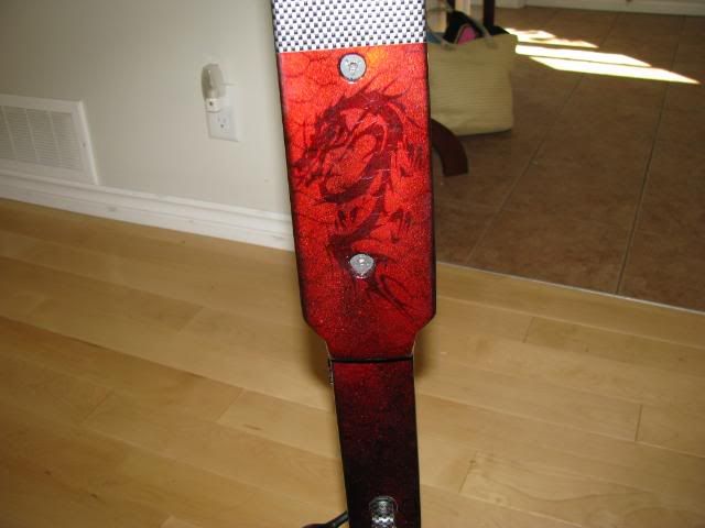

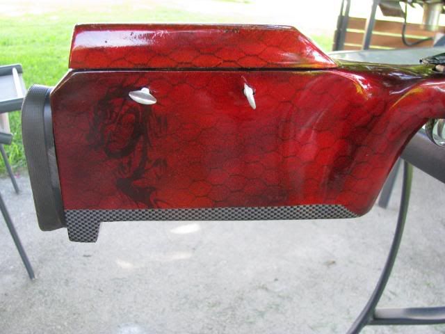

My newly painted 6.5 Mystic sporting a more dragon theme.

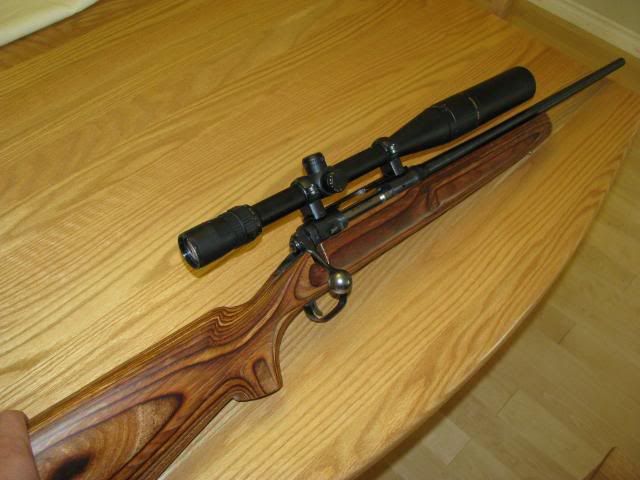

My 6 Mystic in a Richardson Microfit stock. Note the extra inletting needed for the cheekpiece. Now I know why it was on sale.

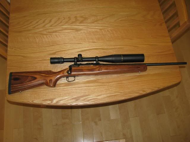

Restocked Stevens 223 into a factory Low Profile stock.
