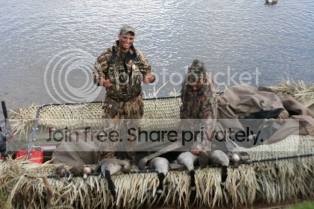

Avery Quick Grass comes in 4 -- 4x4 sheets per bundle -60-70 bucks
I have a 16 ft flat bottom so 2.5 bundles did her good. A collapsible frame was made from conduit painted black. here it is collapsed-

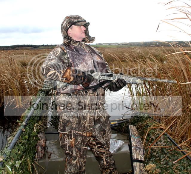

I'm partial to the Avery stuff myself. This is my 2008 Lowe 1852 with a quick-set frame and the avery mesh material. I had quick grass on it but it got wet and rotted out due to some negligence on my part.
