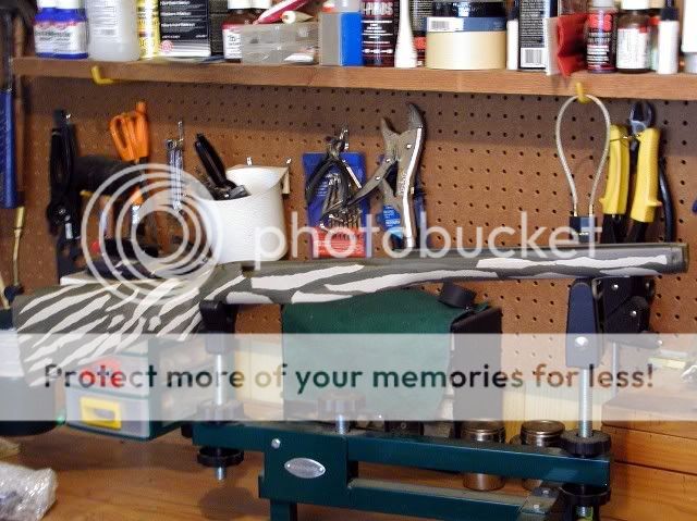

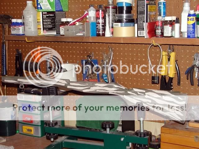

Here's a couple of pics of a stock I did without stencils. All I used was torn strips of masking tape. Do your base coat and add some tape. Paint second colour let dry and add some more strips of tape. Repeat for as many colours you are using. For this stock I used 3 colours. The next one I do I'll use 4 (think it needs some black). It turned out great and the colours seem to shift in the sunlight.
