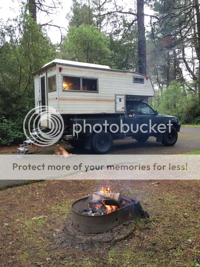

Buy your truck of choice, then find a camper to fit it's bed. Easier than buying the camper and finding a tuck to fit, what I did with my Toyota 4x4. Bought the truck, once I knew bed dimensions it wasn't hard to find an import sized camper to fit it. I did dump a nice chunk of change into it upgrading the rear suspension and adding tie down points and wiring it to charge the deep cell, totally worth it though. I love the set up, it goes anywhere.

Kids most likely are why they get replaced with trailers of fifth wheels, everyone I know with a trailer or RV has a couple kids. The truck camper people I know just have dogs or are single, space gets tight when kids and gear have to come along lol. Wife two dogs and I fit ours perfectly, it'll sleep 4 adults when the bench seat slides out but it would be cramped to say the least...
