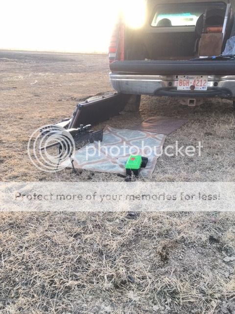

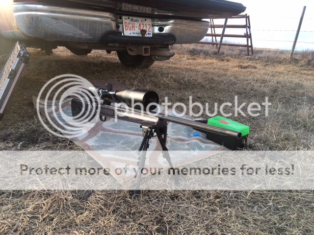

I was able to get the rifle out to the "range", which is just a farmers field whose son I grew up and went to school with. It isn't the best spot for doing this test, but it's more of a realistic situation as to where I would normally be shooting since 9/10 times I'm here shooting gophers during the summer. The goal for today was to sight the rifle in, which I did with a cheap box of Win 150gr softpoints, then test some handloads out. Now I don't have all the fancy kit to say how far from the lands I am or anything like that, so I did it this the only way I know how. When loading I did a dummy round and put some marker on the bullet. I kept pushing the bullet into the case a little further until the lands stopped rubbing the marker off and then gave it a little bit extra just to make sure I wasn't jaming the lands.

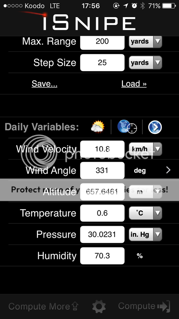

I won't lie, the 168gr kicked a bit more then I was expecting compared to the 150gr Win factory loading. The conditions where also a little on the poor side for shooting, but I was tired of being stuck in the house and needed something to do. Here's a screen shot of the weather where I was shooting.
It doesn't show what my weather app was showing that day, but the winds where gusting up to 40k/m. the Only reason I was even remotely okay with doing a load test was because it was a tail wind for the most part and wouldn't have to big an effect on the bullet.

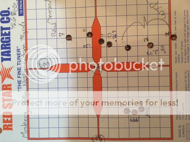

This is the first load, which did no go at all how I was hoping it to go at all. I was rather cold at this point and I was starting to shiver. However even with that, it seemed more like it was a problem with my breathing since there's a huge amount of vertical stringing going on here. I was orginaly going to do 2x 5rd groupings, but the gun holds 3rds so I just went with that.
The shots are numbered, then the circled number is the point of aim for each group. I was actually thinking of just tossing this target, but then decided to keep it.

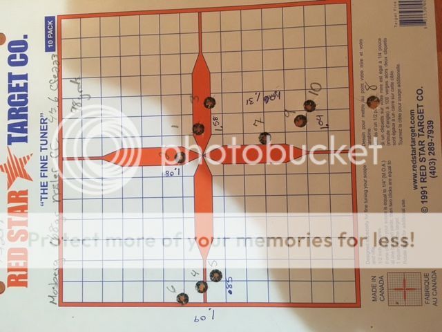

This was the last target I shot, I was still cold at this point, but I was going in and out of the truck to warm up a little between loads. This is the same story as the first set, my breathing was a little off, other then that it would have been some fairly tight looking groups. Of course they could use some improvement, but I also think it's because I'm not use to shooting this rifle still.

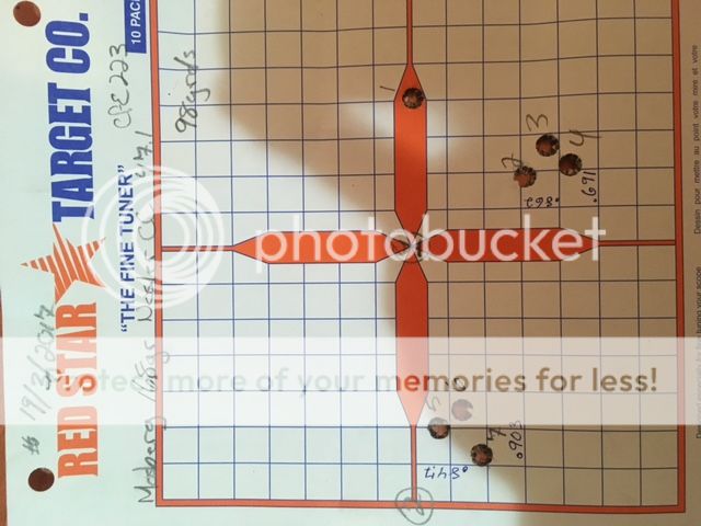

Of course I saved the best target for last. This was with a charger of 47.1gr, I've no idea if this was the rifle or me, but it was the best luck I had that day, so I think I'm going to stick with this loading until two things happen. The first is until it gets warmer and a guy can actually do a proper testing with out chattering. Secondly I'm going to hold off playing with the charge wait until I'm more comfortable with the rifle and feel like I've gotten as much accuracy out of this loading as I can. That's the point where I'll change things and see if I can get closer to a node and reduce the groups further.

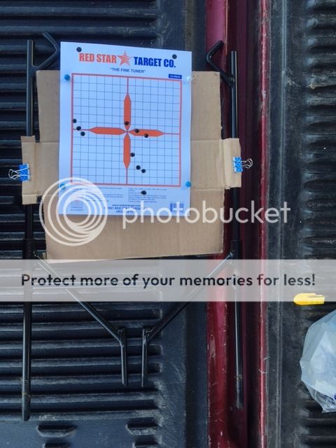

It also doesn't help that I didn't have the greatest of shooting position. I was laying on a couple of door mats that I grabbed off the deck as I was leaving the house in case the ground of wet still......it very much was. I also didn't have the best way of holding the targets in place. I was using the frame of a 9.5" gong that I've yet to shoot.
