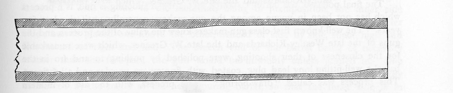

A choke consists of a constriction at the end of the barrel... I don't know of any modified chokes you can put on the end of the barrel. Now it is possible the barrel can be threaded for a choke tube, however the gunsmith doing this will have to measure the barrel first to see if the inside/outside diameters and concentricity allow the installation of the tubes he installs.
