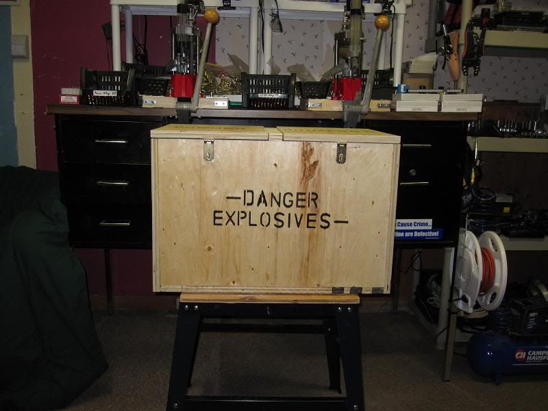

I made mine with brass fittings and screws. 3/4" plywood box separating the primers and powder with two pieces 3/4" glued together inside the bigger box so it's like two boxes sitting side by side but really one box. No need for the danger sign only explosives but I like drama :p.....
