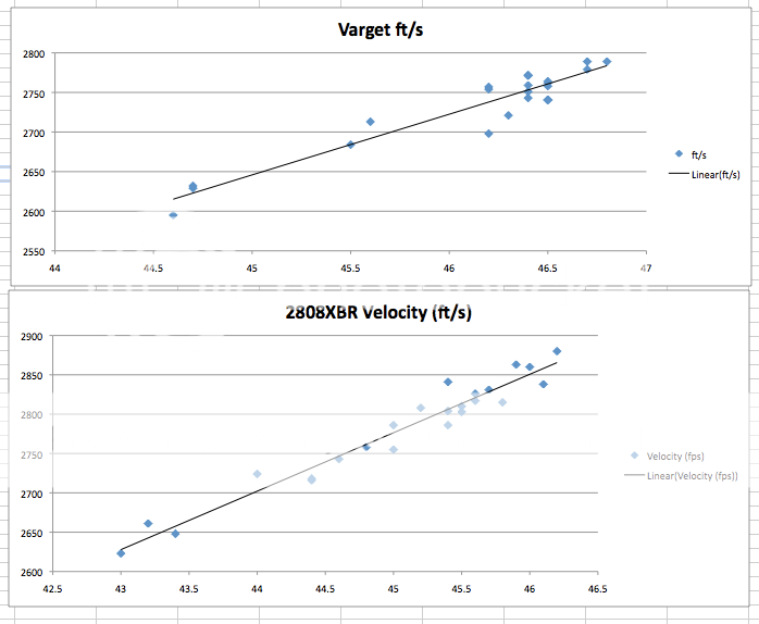

My experience is that the XBR is a faster powder in my 0.308 Rem 700 w/ 26" barrel with 155.5 gr Bergers. I was not able to achieve my goal of 2900 fps with Varget because there wasn't enough case volume for the necessary amount of it.
I am very pleased with the accuracy of 46.5 gr of XBR behind the Bergers. I shot at a 600m range on the weekend and got a significant number of V-bulls, which I was not expecting since it was my first time shooting at that distance.
