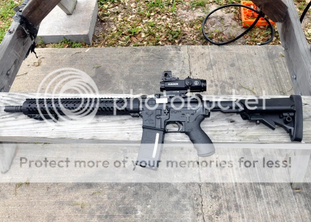

And you get this end-result :cool:
You can also look for a hand guard/rail that utilizes the factory barrel nut. NEA and Troy are a couple that come to mind. But there are many more. That way you don't have to mess with removing the stock barrel nut and reinstalling a new one. Which can be difficult and requires special tools.
For the sight you can just cut the A2 sight off of the factory gas block and use the lower gas block portion on its own. Or buy a low pro gas block. Either way, they aren't overly hard to remove and install.

This is what I did with my Stag 16. The tube is a 15 inch Samson. I used a low profile gas block in lieu of the stock unit and added a Stag 3G compensator.
