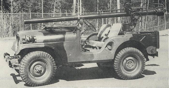

Curious if anyone knows what happened to them (the jeeps and the guns). Were they sold off, melted down?
My M38A1 still sports the brush painted Canadian camouflage . ;)
We had this set on display in 1968 in a mall parking lot. I was with the RCRs at the time. These things were incredibly accurate. The ranging .50 could hit a golf ball at a 1,000 yards. Okay. I never really tried that but it was pretty awesome. I got out before they changed over to the tow. What I heard was that the tow was so damned expensive that nobody got more than one shot in their career in practice so who knew if they could ever really hit anything.

Unfortunately, you appear to be missing the 3rd colour in your camo pattern. It was an intermediate Green, darker than the Olive Drab colour. You can make it out in the black and white photo above your original post, right around the front of the Driver's Footwell where you have painted your center Black Patch. The M38s (and A1s) were always a 3-Colour paint job as detailed in the official "Camouflage" pam. The camo pam detailed the correct placement of each colour for every vehicle and trailer within the Army's wheeled and tracked field fleet.
The 106 RCL carrier M38A1 had bump stops on the rear axles and an extra leaf. The crew seats were sideways on the wheel arches. The spare tire carrier was relocated to the passenger's front side, because the rear panel was cut away for the crew to get out the half-dozen rounds in carried on the floor. Very Spartan as a fighting vehicle.
