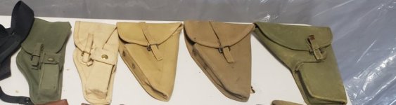

Canadian Hi-power holsters
No idea as to value but being a Hi-power lover they are nice to see. I have the 84 pattern on the far left, same as what I was issued.
no such thing as 84 pattern web gear. These holsters are getting hard to sell. Had several on my table at Chilliwack and not even a nibble. I f you want to move them the 2 on the left are probably around $50 and the others $75
Those two on the left are 64, 51 pattern, they're made of the old cotton web material. (Correction 51 not 64, the 64 had the oil bottle pouch like the later 82 pattern)
An 82 pattern holster is made out the slick nylon type of material that the other pouches were.
Third and fourth from left are 1st pattern WWII, I believe made originally for the Chinese contract HPs. They are poor holsters (well made, poorly designed) that will let the pistol fall out if not buckled down. Far right is 2nd pattern WWII and work well. In the 80s a bunch of them made by ZL&T, unissued, came on the market, so while getting harder to find they aren't rare. Many, if not most, of the WWII, especially the unissued ones, have shrunk over time and are a very hard fit. Lots of tugging and pushing to get a pistol in.

Nice reference line up of the BHP holsters Light Infantry, missing the post war Canadian green leather with webbing shoulder holster and that other totally useless holster, the Bianche UM-84.
