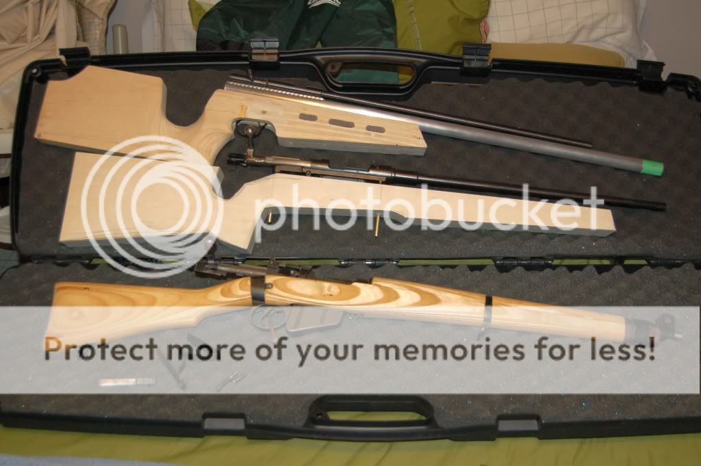

I like Russian Birch plywood from Home Depot. I laminate it into a blank of the required dimensions and have at-er'
I'm working on a Swede Mauser stock at the moment and the ~$35 2'x4' 3/4" "handy panel" has yielded a 2" thick 4'x8" blank good for two stocks. Its a great material for learning on...
