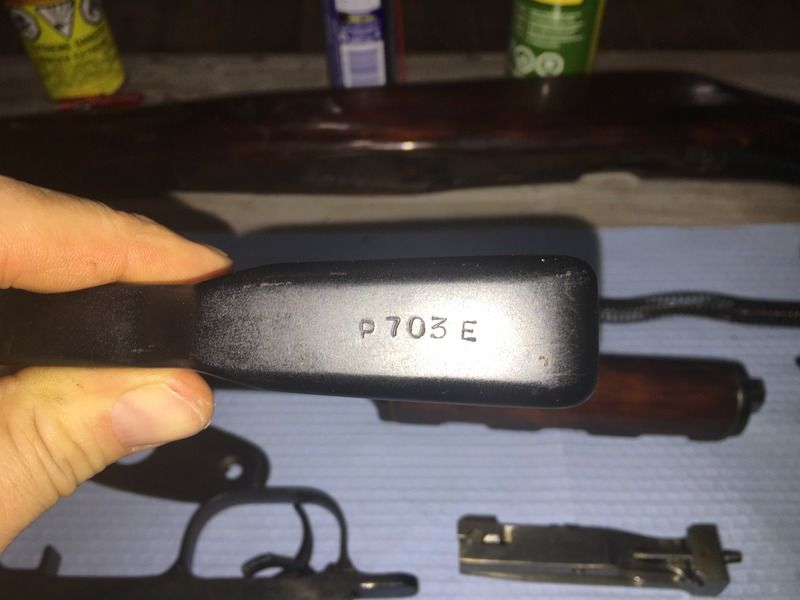

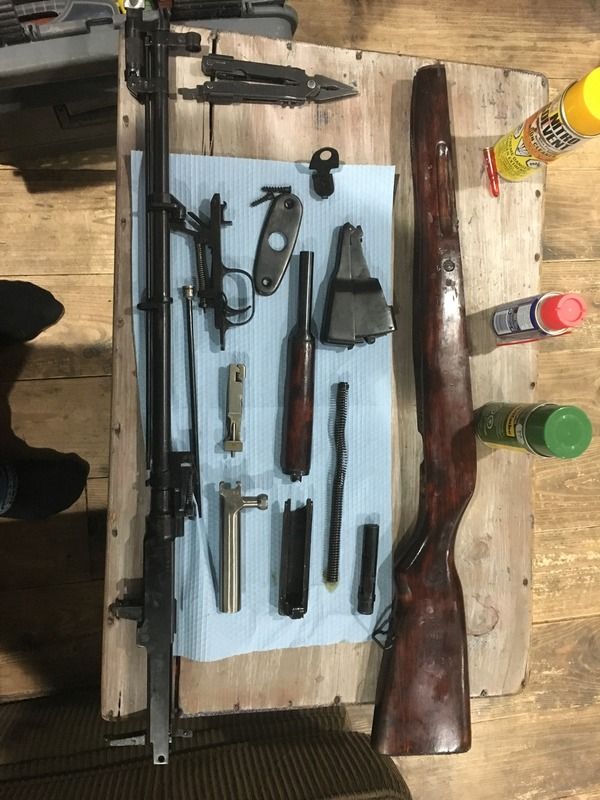

Picked this one up today. Everything matched (except mag), no forced matches and original numbers on the stock. Anyone wanna chime in with details?

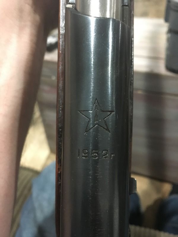

1952 date
Bolt face looks unfired

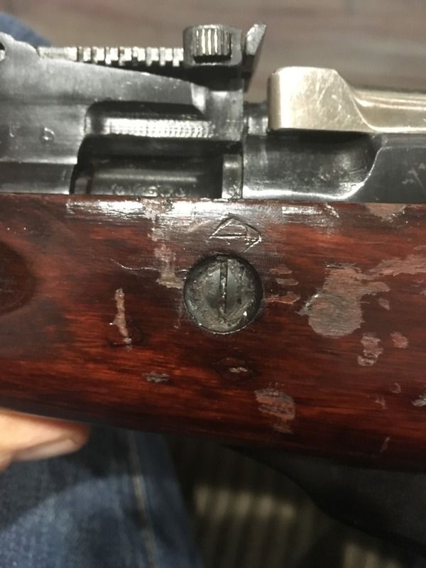

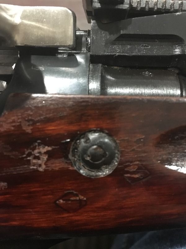

Good looking, might be un-refurbished, but we would need close ups of the receiver cover and the front cross-bolt area of the stock.

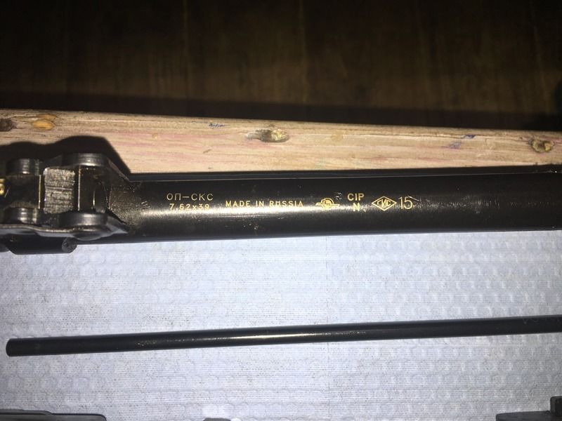

The gold laser etching is standard for the Russian imports now.
Its rough around the cross bolt

Beautiful! Blued, no obvious refurb stamp on the receiver cover, front cross-bolt stock markings look original. Probably un-refurbished and if you say
the internals look unfired, perhaps you have an un-issued. You picked a winner! Tula factory made in 1952, normal handling bruises on stock.:d

Looks nice. the Mag is'nt origional but the blued cover and the cross bolt stamps are great. the picture of the stock was too far away but it still looked Dated . - the star and the date with number ?? good find. I'll bet it shoots nice.
