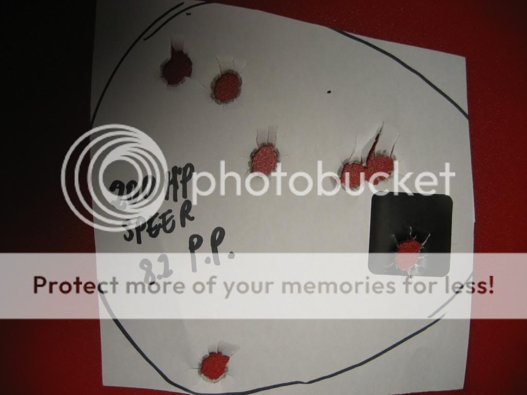

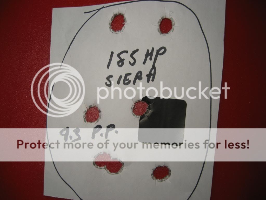

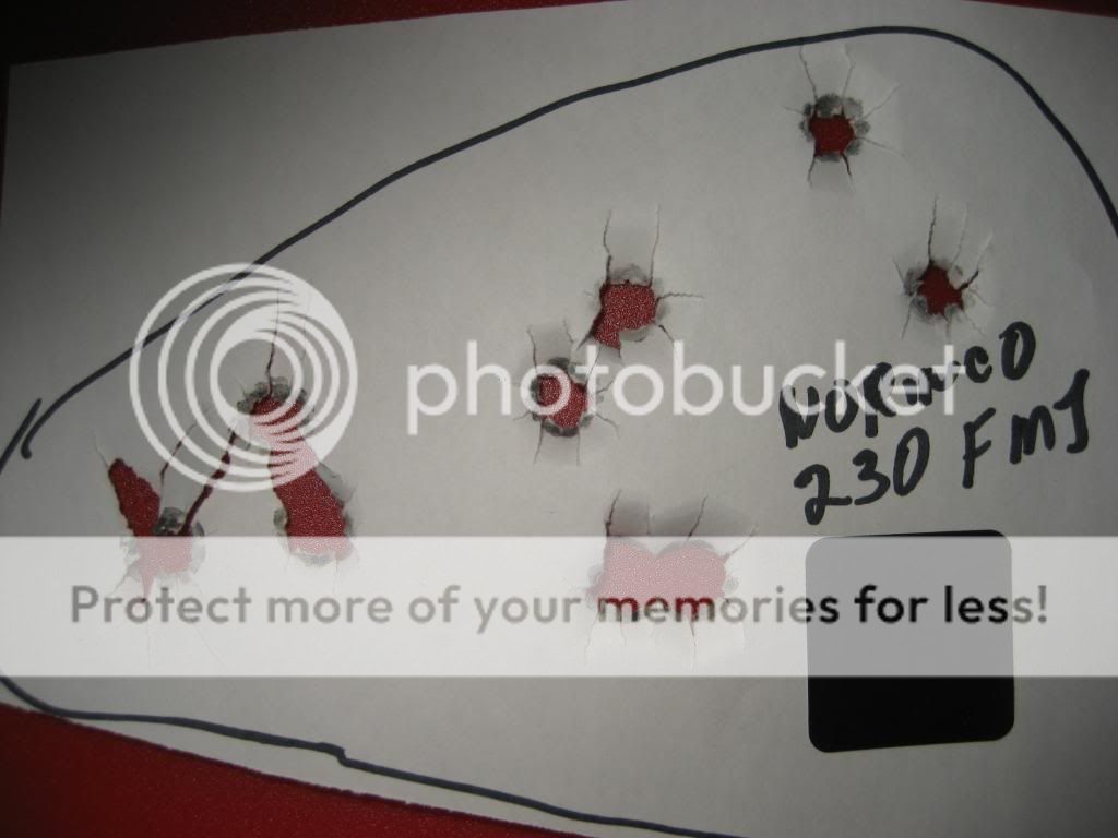

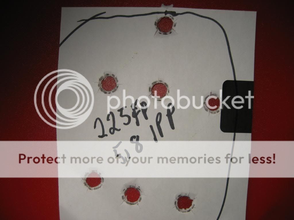

Today I went back to the range and shot an assortment of ammo I had on hand. The mild loads shot terrible, but the hot loads did just fine.
Before the trigger job, the groups were about 4" low and left. Now elevation is perfect and groups average about 2" left. This model 1911 has what i consider a short trigger. I have medium-large hands and would prefer a longer trigger. With this one I tend to stick too much finger in the trigger guard, and this skews my groups. I will order some longer triggers. They are cheap.
These groups were shot at 25 yards. I was standing, shooting two-handed.
