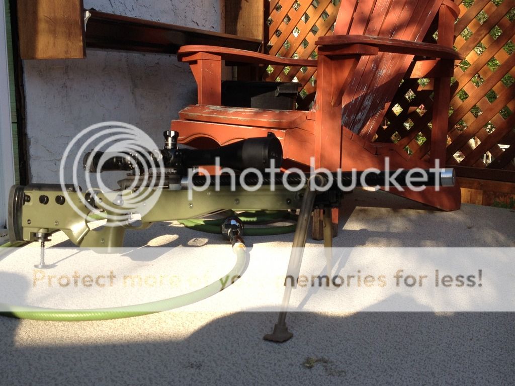

so first some pictures, cause the best threads have pictures:
So, basically I decided to build some aluminum pucks to slide over the small pencil sized barrel on my savage B mag 17 WSM (mounted in an AICS airsoft knockoff stock with millet LRS, aftermarket knock off bipod and vector 35mm rings), I had bought some 30mm carbon fiber tube a while ago, two pieces were around $80 to the door from china via the interwebs.

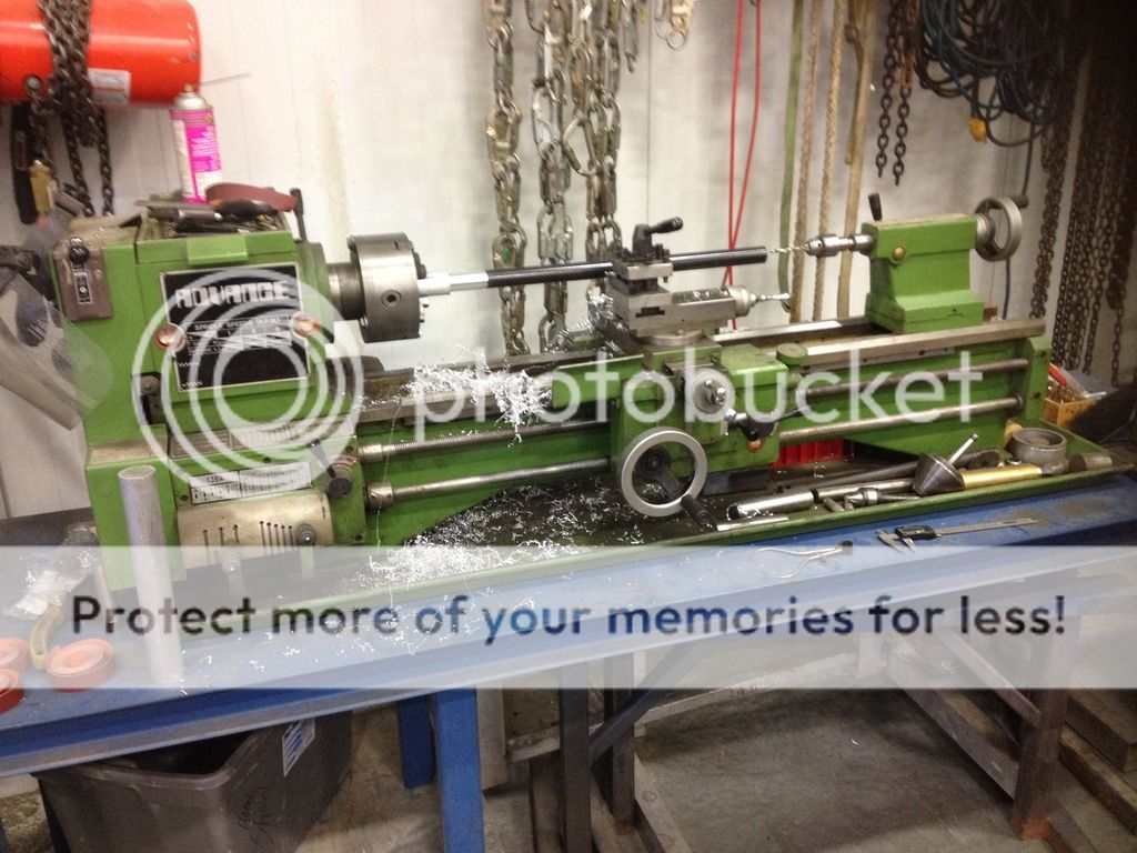

A friend of a friend has a small shop north of Calgary and let me play on his little lathe and milling machine as long as I didn't get blood on anything, the rear aluminum end has basically a bedding block piece which provides a better/connected surface to mount the action to the AICS airsoft chassis, the tube and aluminum ends got epoxied together last night and epoxied to the barrel with a little bit of hesitance.

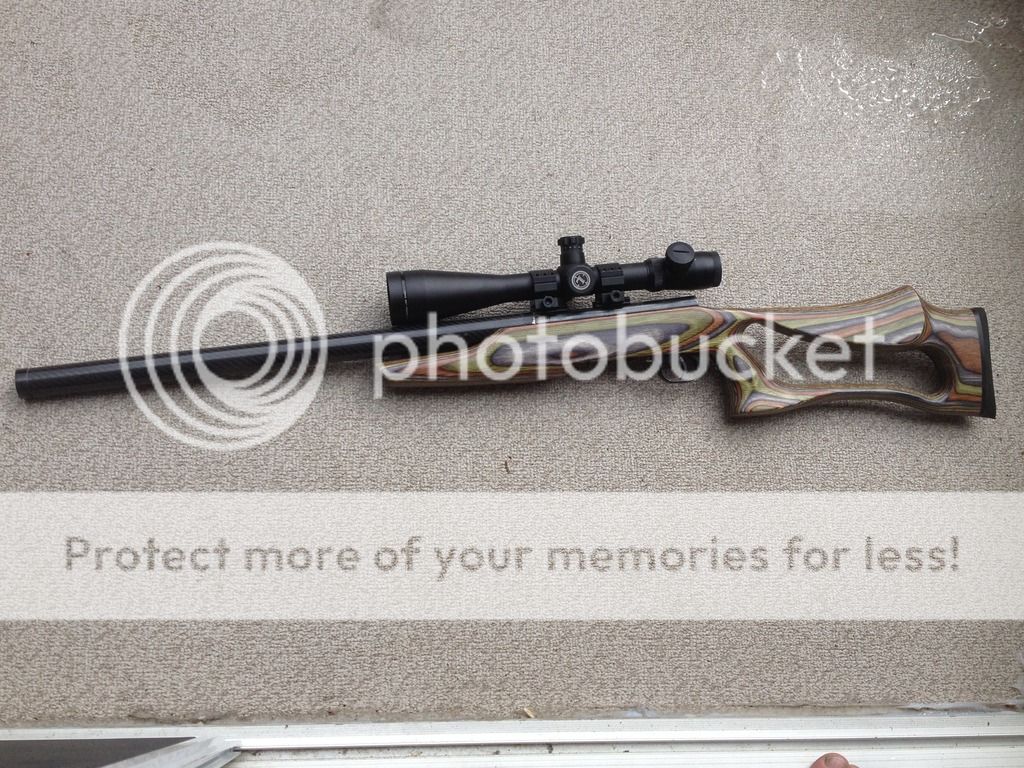

I also put a lakefield mk II in a boyds evolution forest laminate stock, it got the same treatment but I haven't taken pictures yet, will be waiting for slightly taller scope mounts to show up in the mail for it, also have quite a bit more work to do with the B Mag, Modified a .22 mag magazine to feed .17 and need to weld a bit of metal on it and get it feeding the .17 plus lots of other little stuff on it.

The lakefield, doesn't look much like a lakefield anymore either. Can't wait to get the new mounts for it.
I had a look at it yesterday, the front plug hasn't been epoxied yet as I have to cut down the carbon sleeve a bit, but I was able to see how stiff the sleeve was by squeezing the barrel and one side of the sleeve between my thumb and forefinger, it's actually much more solid then I thought, basically I could feel some deflection of the barrel at the point where I was pressing hard enough to deflect the carbon, so off the cuff I would say that despite this not being made to conventional modern methods, it should still provide a more rigid overall barrel, off the cuff I'd guess 20-40% maybe.

Took the two rifles out this morning, light wind, really hot and there were a few horse flies out today, but it shot alright, a picture of the 17 now with the aluminum painted and the barrel sleeve epoxied on, I'm quite happy with it but I need to get it out shooting more, I blasted off three 5 round groups at 50 yards, 20 grain winchester, 20 grain american eagle and 25 grain winchester left to right just to see what shoots better of the three.
The .22 also shot ok but not quite as nice as the 17, and I left the magazine at home so it was a little slow to feed.
I shot a decent 5 round group at 100 yards but the last round hit the metal behind it and exploded leaving shrapnel holes through the group, when I get it tuned up a bit more I'll post some more results, but I think it should easily do 1 MOA.

Did you tension the barrel between the aluminum pucks?
Nope, probably would be smarter performance wise but I'd have to thread the end of the barrel.
When I put the Millet LRS on it with it's big 35mm tube it made the barrel look silly small, most of this came about for aesthetic value, though I could see that being the next step with the next rifle I do.
I fired about 30 shots with it in about 5-10 minutes, didn't really notice any significant heat deflection, the 3 five shot groups were shot within about 5 minutes right after getting it roughly sighted in, so it doesn't seem to be hurting it in that aspect.
