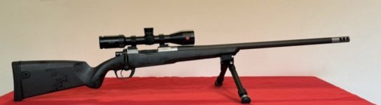

My older brothers 300 PRC-26" Benchmark 1-8 twist barrel

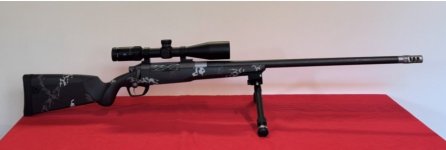

My 300 PRC 26" Benchmark Barrel 1-8 twist

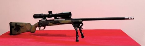

My Nephews 300 PRC 24" Benchmark 1-8.5 twist

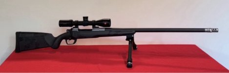

The other Nephews 300 PRC 26" 1-8 twist Bencmark

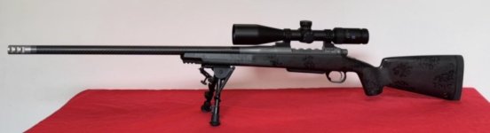

My 7-6.5 PRCW 26" Benchmark 1-8.5 Twist
