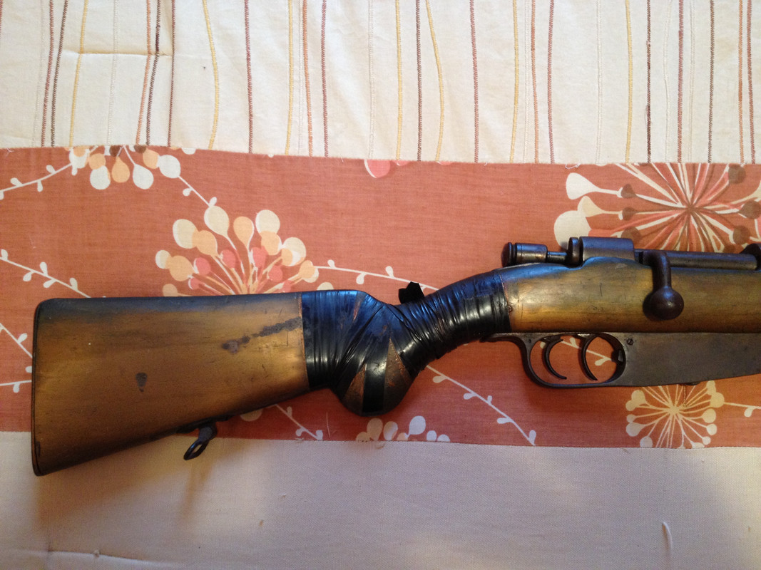

I would say that both are definitely Cooeys. The one has only a single trigger; chance are the other trigger has been removed. That did happen a lot and is the reason I had to buy a second one!
