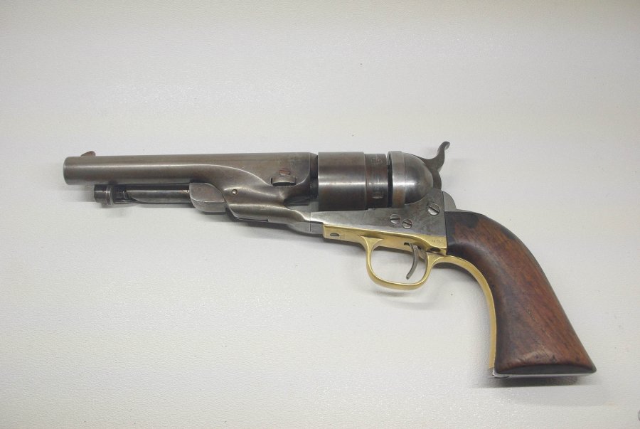

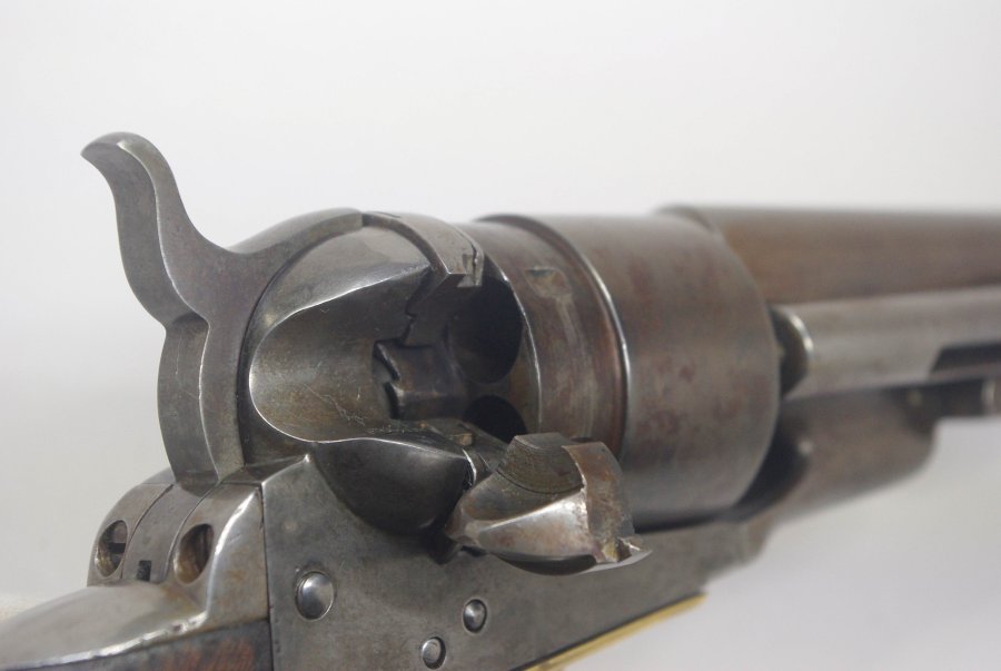

Colt M1860 Army Conversion to .44 Colt Center Fire
Adaptation of a Colt 1860 Army to cartridge use: recoil shield milled out, integral floating firing pin housed inside the breech plate, cylinder ratchet extended to reach the hand, bored-through cylinder, loading gate, extractor. The rammer was removed and the lug used to mount the extractor.

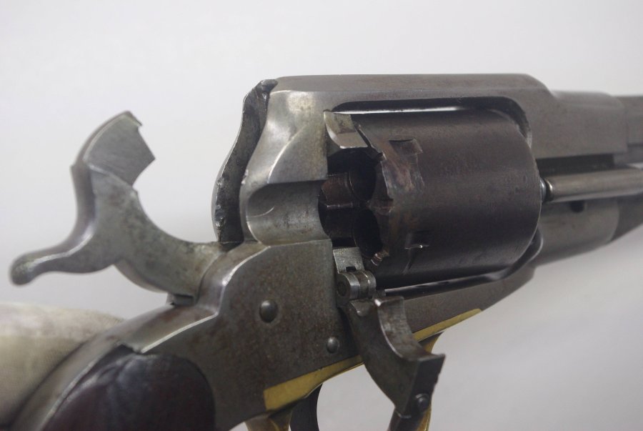

Remington New Model Navy Converted to .38 Rim Fire
Cartridge conversion of a Remington New Model Navy: recoil shield milled out, breech plate with loading gate inserted, bored-through cylinder with extended ratchet, extractor. Note that the hammer has not been changed, and the rammer was left intact. This method of conversion would likely have been cheaper than the Colt conversions.
