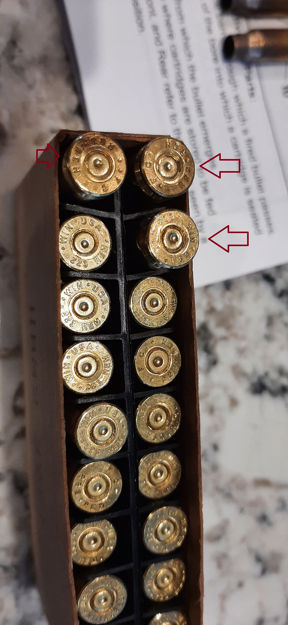

Attached is a photo of the cartridges fired yesterday. The taller ones, obviously, are the ones that did not go off. You can see that one had a couple of pin strikes. The photo might be hard to tell from but to me, it looks like they all had similar strikes.
Which is not good news, I suppose. It would be nice to know that something influenced the pin impact. Regardless, after cleaning again, we will see if it makes a difference.
Well those are faintly light strikes anyway, at least the top 2 are. Take the advice of Mr Woodchopper.
