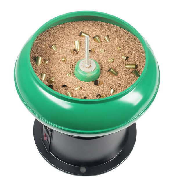

The cheapest solution is probably a vibratory case tumbler. Dust and capacity (to some extent) are the negatives. Wet tumblers do cost more but personally that's what I would recommend. You can make your own if you're handy but you'll have to decide if the savings are worth your time and effort (I don't think so). Some loaders also use a cement mixer. These offer the largest capacity but they're pretty expensive.

But yeah, if you’re doing bulk pistol brass you’ll need to invest in a device. Wet tumble with steel pins makes brass look new. Walnut vibratory is cheaper and less steps than wet/pins.

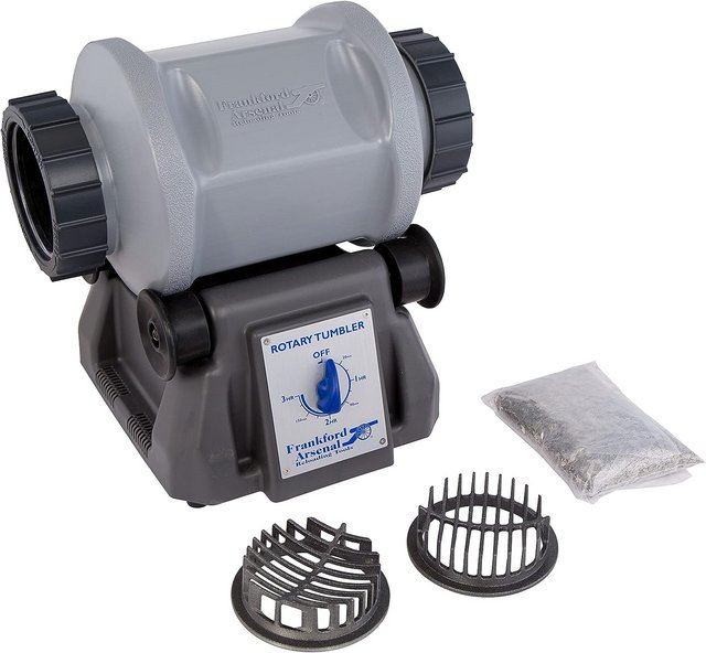

I have a Lyman vibratory tumbler and crushed walnut media I use for smaller batches (50-200) of cleaner pistol brass, once fired or my own reloads. For bulk range pickup or ipsc brass (multiple 5 gal pails) which is filthy I wet tumble in a Frankford Arsenal with stainless pins and some laundry soap and citric acid, I tried the vibratory tumbler on the ipsc brass and it didn’t get it clean and took way to long for the amount that I could do in one go.
The wet tumbler with pins is worth it if you’re doing any level of volume or really dirty brass, once you get it spotless you can use the dry tumbler in smaller batches. I add a cap of NuFinish car wax and a squirt of varsol to the walnut media to help with cleaning/polishing and to keep dust to a bare minimum. It’s not worth the time to cobble something together when there’s good options available already, the FA wet tumbler comes in two sizes. I’ve tried just water and stainless pins and that works pretty damn well, less rinsing without soap.
The first pic is ipsc brass that was dry tumbled on the right and wet tumbled on the left. I use a dry media separator to spin out and seperate the pins.

There should be two types of reloaders out there. The ones who wet tumble, and those who are looking to upgrade to wet tumbling.
Besides the price, I cannot think of a single reason one would choose to use a vibratory tumbler…
The only reason that I can think of, not to go to wet tumbling, is the hand loaders who question the whole point of any kind of tumbling - gets back to that "clean" versus "shiny" thing. I can not say that I have ever shown myself, with my guns, a difference in group size with or without a "shiny" case.

https://www.rcbs.com/case-processing/cleaning/vibratory-case-polisher/1000811.html
