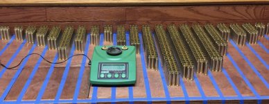

I agree that when you are dealing with brass with a maximum case weight ES in the range of 1.0-1.5 grains, weight sorting likely does not add any value. However my experience with this range brass was somewhat different.
I weight sorted the brass once, after the original prep. There was a large weight variation in the original prepped brass (4 or 5 grains) so I believed weight sorting would improve chamber pressure consistency and maybe accuracy. I culled all weight outliers.
As per the trimodal distribution of the weights, I could tell the cases came from at least 3 different lots of ammo. It was an interesting exercise.

With more expensive brass usually means less prep work, but I will weight sort after sizing and trimming before loading. Once this is done those cases stay in MTM ammo boxes pretty much their whole life. All similar weight boxes go through one process as a batch before moving to the next weighted lot, all through the loading process.

Using your bell-curve sorted brass, use the "ends" for sighters & sort the rest into lots for serious work.

To maintain a consistent pressure, is case volume consistency more important than weight, and does weight correlate reasonably well to case volume?
If so, it certainly is easier/quicker to measure.
