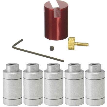

Bought a headspace comparator now to set up dies better
Should be here tomorrow.

The cheap way to measure headspace is with a deprimed and trimmed square 44 Rem Mag case and a set of cheap digital calipers. The 44 case works well enough for the 308 case family all the way to the belted magnums. Other pistol cases work too, or any other round bushing that sits on the middle or so of the shoulder.

Below I'm measuring a fired case from my AR15 rifle, I then set the resizing die up for .003 shoulder bump.
The case springs back from the chamber walls and the case shoulder is not a snug fit in the chamber. Meaning the case is approximately .004 shorter than actual chamber headspace after .003 shoulder bump.
The general thumb rule for shoulder bump is .001 to .003 for a bolt action and .003 to .006 for a semi-auto, pump or lever action.
