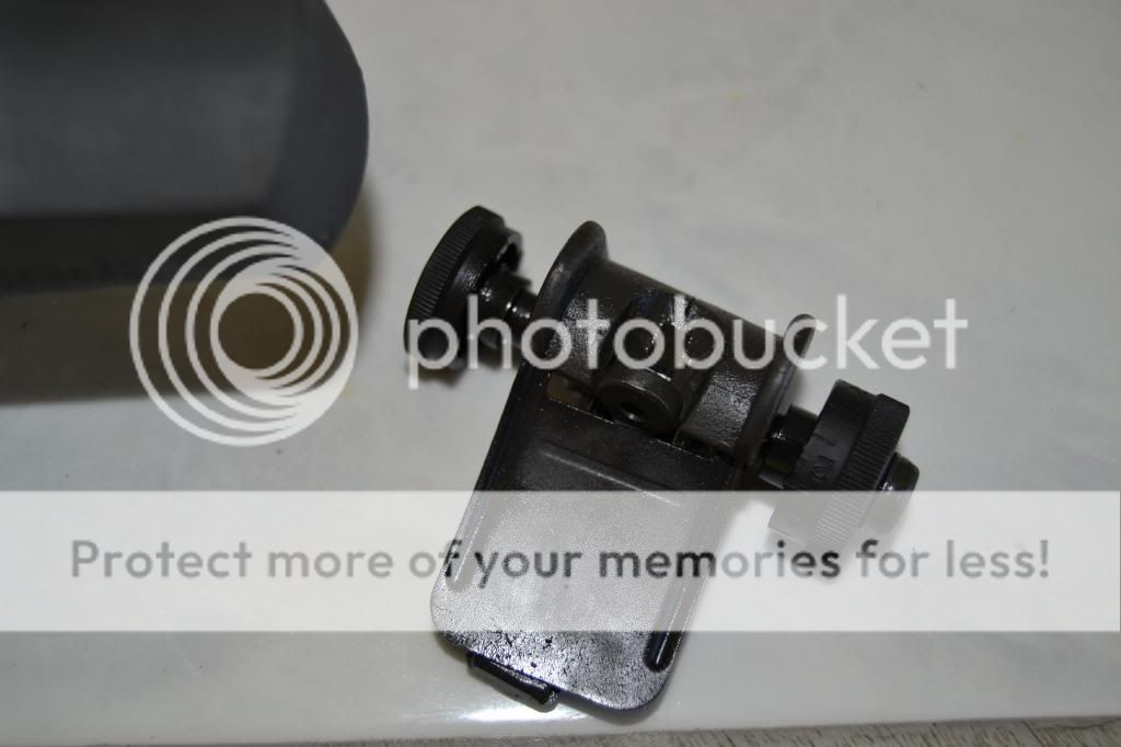

This is how it attaches
All nice and snug
You have to remove these of course
