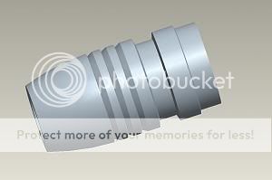

I designed a light weight cast bullet that is hollow point or solid and it works great.

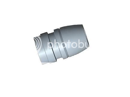

Myself and another member designed this one as a multipurpose bullet with three crimp grooves. Top groove is for .444 Marlin, center is for .44 mag rifle and lower is for .44 mag revolvers. My .444 and .44 mag rifles love this bullet as does my model 629 and redhawk revolvers.
It has taken many animals over the last couple of years.

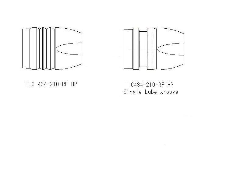

Just a couple of drawings I did for a light weight .444 bullet. One with tumble lube and one with regular lube groove.
Also look at Ranch Dog's website, he has a few different weights that he offers and they work excellent also. He prefers the Tumble lube for easy lube application so most of his bullets are that style. You can also get his bullet designs in regular Lube grooves from NOE in Utah and he can hollow point them if you want. You can get the correct Tumble Lube sizer .432 on Ranch Dogs site and they work great. http://www.ranchdogoutdoors.com/
