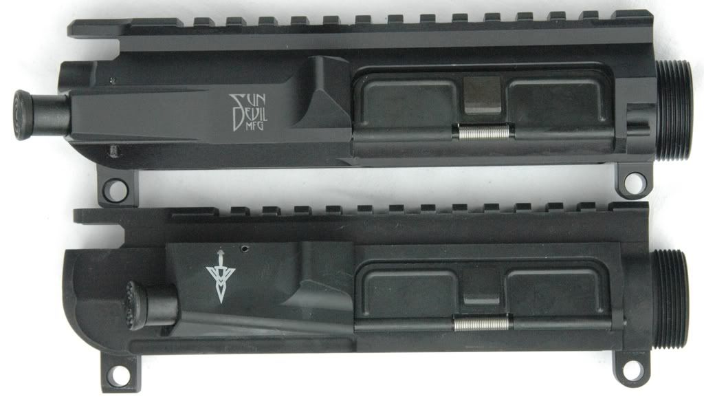

You can beat the billet vs forged horse to death but you can't argue that from the pictures below most billet uppers are far heavier in certain areas
Top is a Sun Devil Billet, middle a RRA std, bottom is a Vltor MUR ( FORGING ..new MURs are made from a forging )
As you can see the walll thickness is much heavier ( you can see the notch to clear the bolt release ). The Larue Stealth is also much heavier. I will post pics later

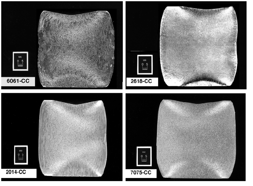

One of the reasons is 7075 does not behave like "other aluminums" and other ferrous materials when forged. Here is a picture that illustrates this
Picture is macroetch of aluminum billets that has gone through a 50% upset forge
As you can see ever popular 6061 exhibits noticable change in grain structure ( dark regions ) . This is perfect example of "forged is stronger" argument. Please note that 2000 series exhibits grain changes to a lesser degree where its been squished down. You can see that these alloys are "lined up better" after forging
Interestingly the 7075 does not seem to exhibit this change in grain structure.
Its easy to make general statments from limited info. As mentioned earlier, material science is far more complicated that you can imagine to make blanket statements that forging is stronger than billet.
