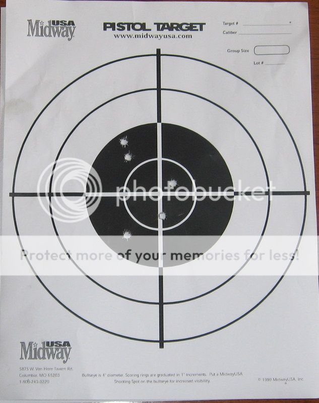

I was able to put 500 rounds of cast bullets through an AR-15 without cleaning it and did not have any problems or malfunctions at all. The test showed (to me at least), that AR-15's can be made to work consistently with cast bullets. In regard to accuracy, I didn't see any significant change in accuracy, but I wasn't really testing for it.

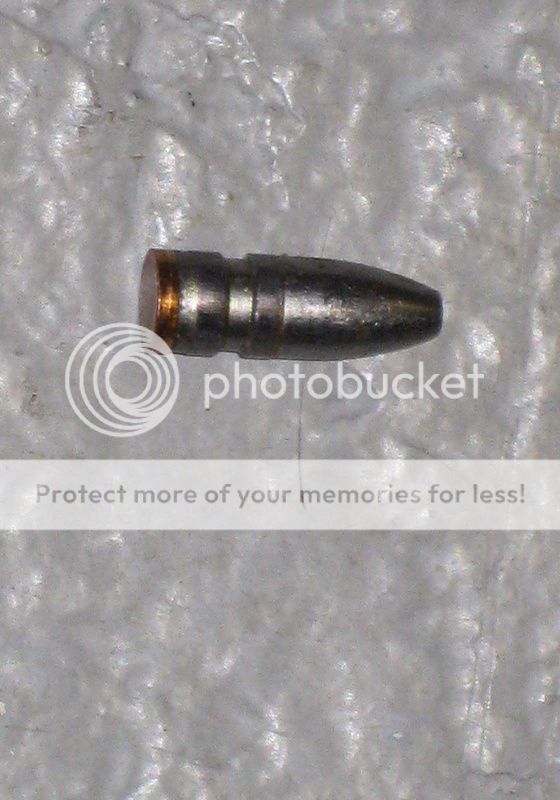

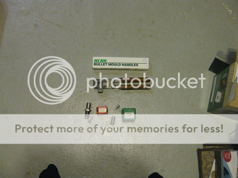

Yes I have done it and yes it can be done. I used an nei mold with gas check. Used the oven method for hardening the bullets. That said I found that working with the smaller projectiles a real pain. The bullet has a flat base which is much more difficult to seat then a boat tail. It gets old fast and 224 jacketed are relatively cheap. I used in an AR 180B and was able to get it to cycle.
