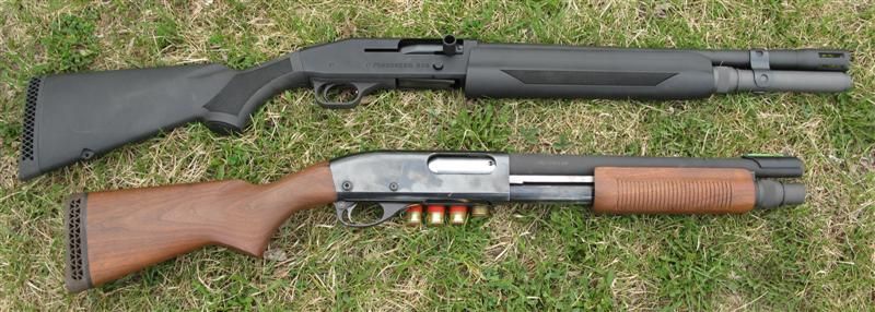

Nope.
It just has to be a continuous, one-piece length, rifling is irrelevant. Otherwise, the Mossberg 930 Tactical wouldn't be non-restricted.
Barrel length would be under 18.5" if the muzzle thingy didn't count.
