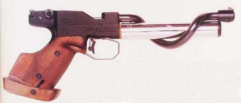

Feinwerkbau actually made a target air pistol that had a barrel which did a complete wrap around the air cylinder, like a plane doing a barrel roll (pun not intended) to prove that it really doesn't matter so much what it does until the last few mm of the barrel. It shot as well as their guns do.
